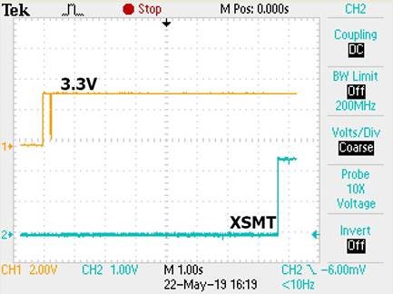

PCM5100A: Audio Line Out Issue/Headphone Pop Noise
Part Number: PCM5100A
Hi team,
When the power is turned on, there will be pop noise appearing in line out. We have used XSMT mute for about 7-8 seconds as below figure.
However, when I2S_CLK has a signal, it will hear a very obvious pop sound. Now it is -22dB, which is much worse than the specification -60dB.
Would you have suggestion to improve it?
