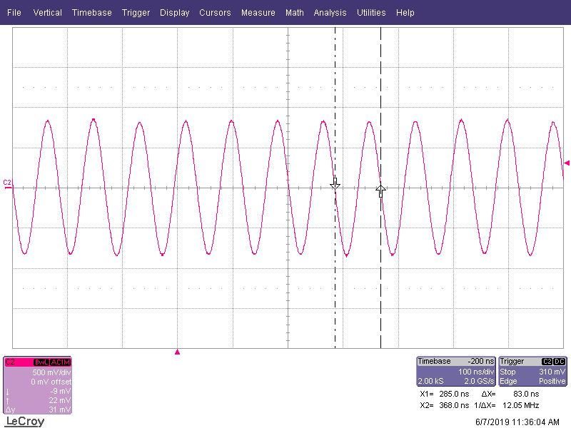

Hi I have attached some scope shots of the output showing the noise when the output is enabled.  Can you give me some debug tips, and also should the MCLK signal be more of a digital signal than a sine wave- there is nothing I could see in teh data sheet about this.
Attached are three screen shots. 01-away-volume-level7.bmp and 02-away-volume-muted.bmp show the noise we are seeing at the output of the codec. 03-SC_SYSTEM_CLOCK.bmp is the system clock line. Put some cursors round this and it measures 12MHz, AC coupled.

  • HI Steve, The output does have this RC filter, unfortunately the noise is not out of band I suppose, it shows up in the audio spectrum as a mush type noise.  The have seen other posts that suggest the line outs should go through the mixer channel ( even though it has higher power consumption) because the mixer has a filter built in, would you concur.   Can you get noise like this if the master clock is jittery or needs improving- Is there a way to check if the clock settings are done properly?  The output amp is a class AB btw the TPA6211A1 driven single ended though.  Are there any other things we should be addressing or looking at a bit more closely, such as clock jitter?

    The Master clock should be a Square wave,  and having a sine wave would definitely cause more jitter, and lower performance.
    Where is this MCLK coming from?  is the codec in Master mode?

  • HI Steve,
    we will clean up clock to square wave and see if that improves the noise
