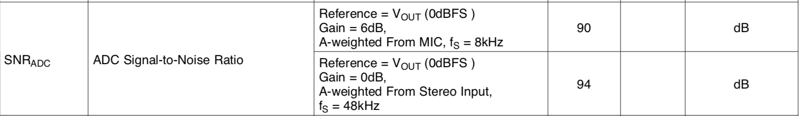

For the audio noise floor issue(background noise). We have fully verified that it is necessary to clarify the difference in noise floor of lm49350 at different sampling rates.
Problem phenomenon:
Two test methods test the noise floor:
1. Mute DAC (0x30h) measurement: the noise floor of 16k sampling rate is -59.8dbv; the noise floor of 32k sampling rate is -67.5dbv
2. Measure by playing silent file: 16K sampling rate noise floor is -52dbv; 32k sampling rate is -59.6dbv
 The 16k sampling rate has a noise ratio of 32k and a sampling rate of 7db. There is also a significant difference in subjective comparison. I hope to confirm whether the codec has a difference of about 7db at different sampling rates.
