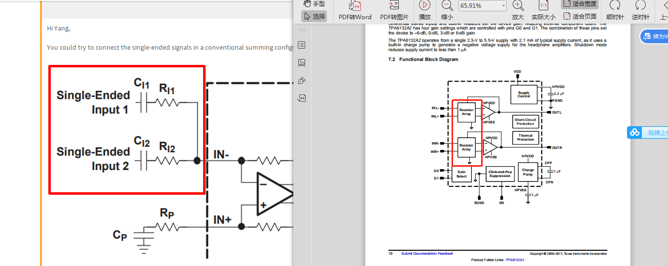

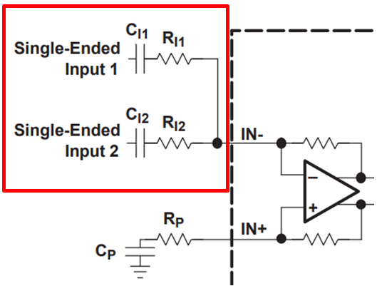

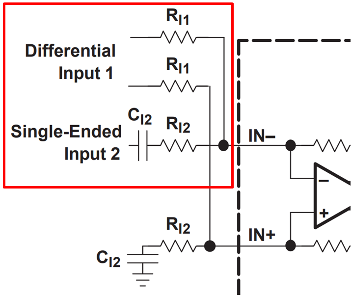

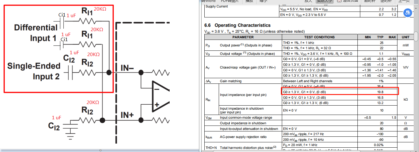

Hi team,
 My customer has an headphone application using TPA6132A2.
The input signals are the denoise differential signal and single-end audio signal.
My question is that can the single-end audio signal be added to the denoise differential signal, then be inputted to TPA6132A2 together? And do you have reference design?
