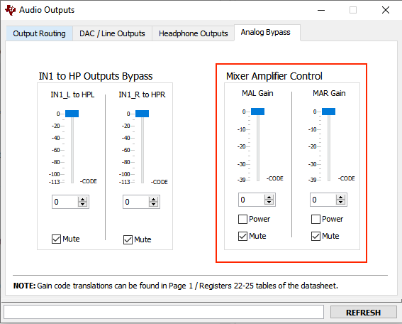

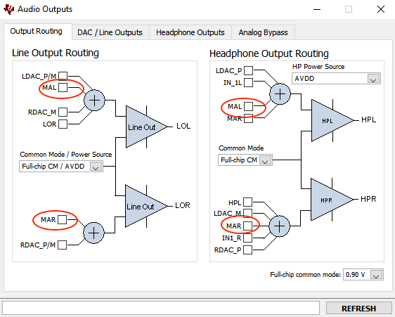

My costomer required one of the analog in or I2S in at one time, and line out and I2S out simultaneously,
I configured the audio input and audio output settings by CS tool, enable the analog in and I2S in, and enable line out and I2S out.
but the result is when I input analog and digital at the same time, analog only output to I2S, and digital only output to line out, independently.
So what configuration do I miss to set up?
Do you have some demo code for reference? please help.
thanks.
  • Tom,
    If you are using the AIC3254CS GUI the controls for the Analog bypass are under Analog settings>>audio outputs
    the outputs must have the MAL and MAR inputs assigned,  and then the MAL and MAR mute must be disabled .
