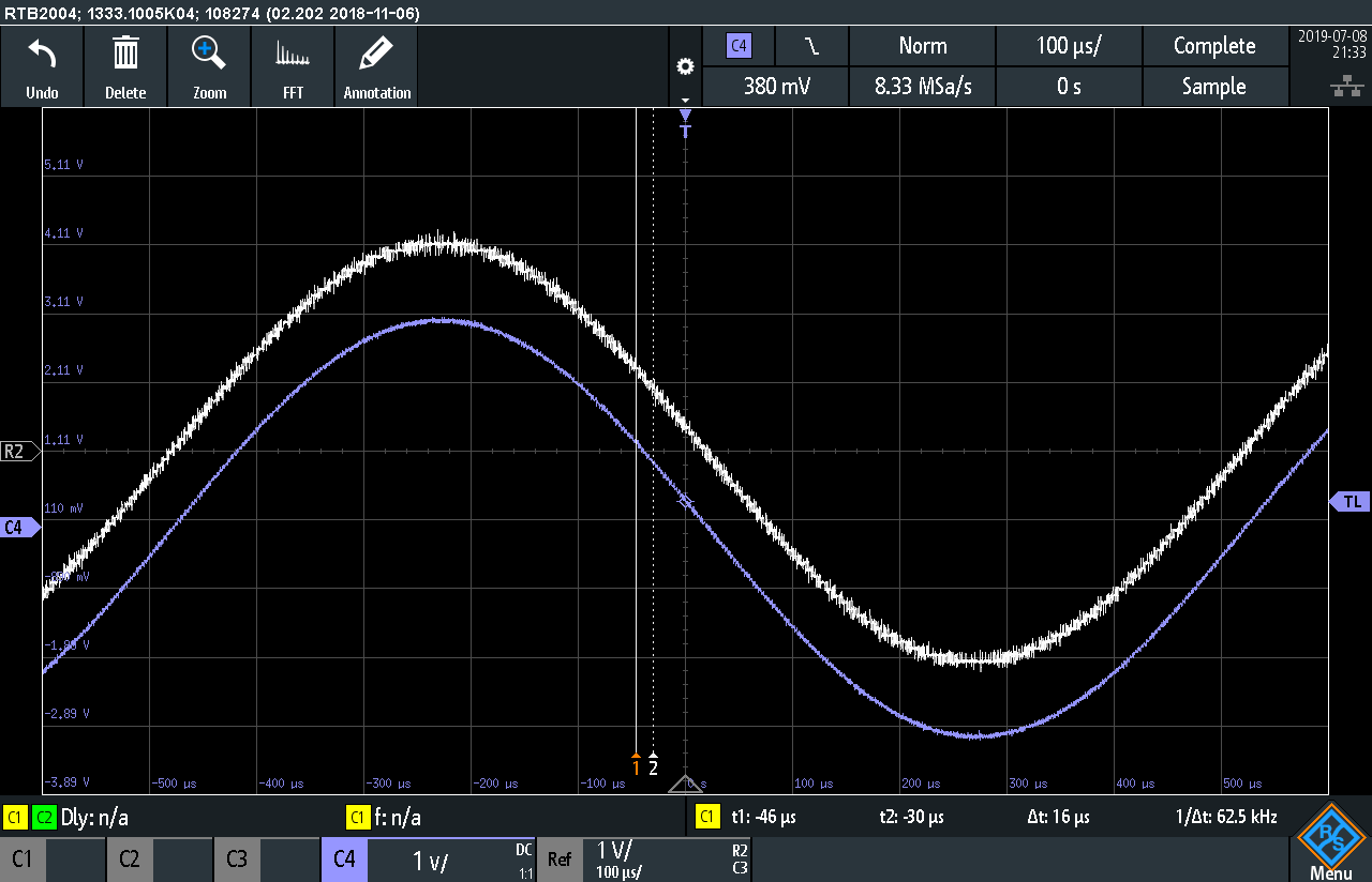

I have however discovered that while at 1kHz (any sample rate) the waveform clocks in a respectable 0.002% THD+N and looks smooth, the 20kHz is clearly stepped on scope trace  and the effect does not change if sample rate changed. this measures a whopping 1.3%. Picture attached of main signal (top) and THD residual (below).

If I put 80kHz filter in THD at 20kHz drops to 0.16% which is several orders worse than the spec sheet seems to suggest...
The stepping is also not scope artefacts; I've tried another different design dac unit in same setup and this effect was not apparent.

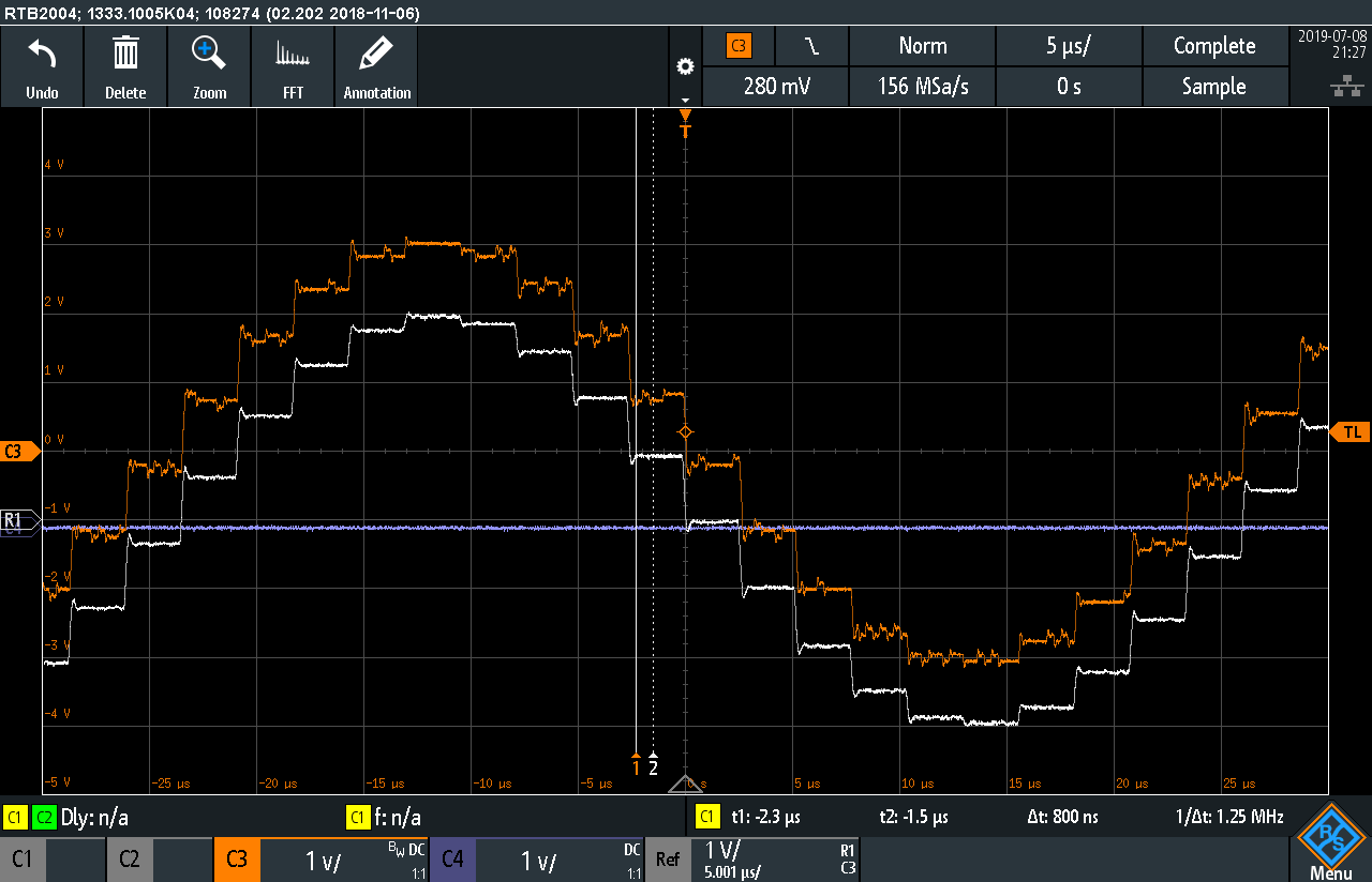

    I think it is important to understand the differences between the two DACs: PCM1792 and the PCM5242.  Both of these devices feature a delta-sigma current segment modulator, but with different digital fitlers and modulator architectures.  The PCM1792 features an 8x interpolator, while the modulator runs at 64x the original sample rate.  The PCM5242 has a variable interpolator that will up-sample to 384kHz regardless of the input sample rate (within limits).  It's delta sigma modulator runs at a much higher frequency, about 6MHz.
    Consider the an experiment where I use the same 48kHz input sample rate for the both of the PCM devices with no external analog filters.  Both will effectively up-sample to 384kHz.  See the image below:
    The white line is the PCM5242 and the orange line is the PCM1792A.  You can see that they have the same amount of interpolator points per sine period (and quantization noise).  The main difference is that you can see the DSM switching on the PCM1792A.

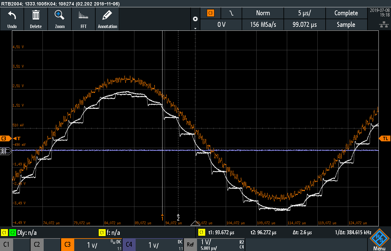

    When you use a higher sample rate, this will look better on the PCM1792A:
    In this image, the white lines are the PCM5242 (one is filtered with the LPF, the other is not) and the orange line is the PCM1792A.  The sample rate is now 192kHz, so the PCM1792A is interpolating at 8xfS, and has a total oversample rate of 64xfS.
