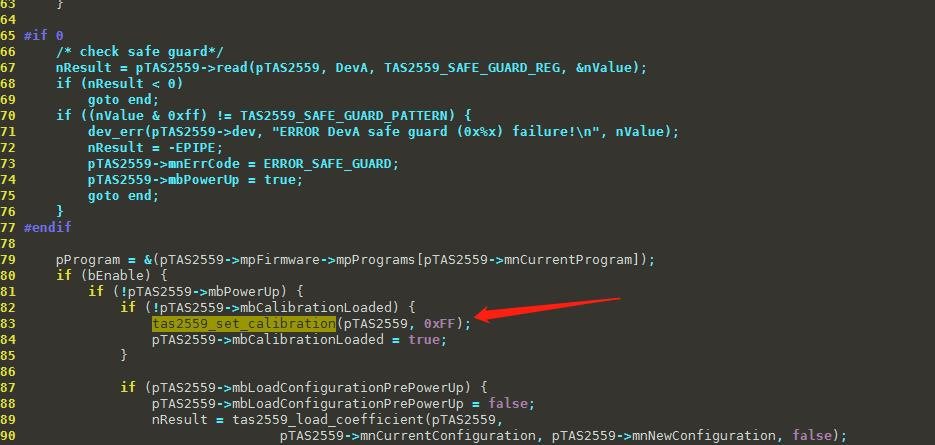

3.Safe quard related error I skipped part and proceeded,
We need the binary file /data/tas2559_cal.bin in the function of the below red-arrow.
Is this binary a Dump binary generated by PPC3? Or, please advise exactly which binary file you mean..

  • Hi Anthony,
    I'll comment on the error you're seeing in your other e2e post.
    Regarding the _cal.bin file, it is generated in calibration.
    -Ivan Salazar

  • Hi Ivan
    Thank you for your reply.
    There is still something I do not understand correctly.
    cal.bin file is created by calibration, is it different from the bin file that is generated from the PPC end system menu that I mentioned? If it is something else, can you explain in more detail the process or method of creating cal.bin?
    Thank you.
    Best Regards.
    From Anthony.
  • Hi Anthony,
    cal.bin file is different than the one generated from End System Integration panel within PPC3. It is obtained during calibration with ftc tool.
    If you need further details about the device tools, you can send me an email to: ivan.salazar@ti.com I can gather some information from our driver development team and share with you.
