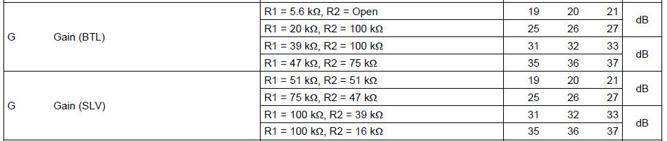

    TPA3116D2 has different gain settings, what will be the current for each of the gain setting as shown in the image below

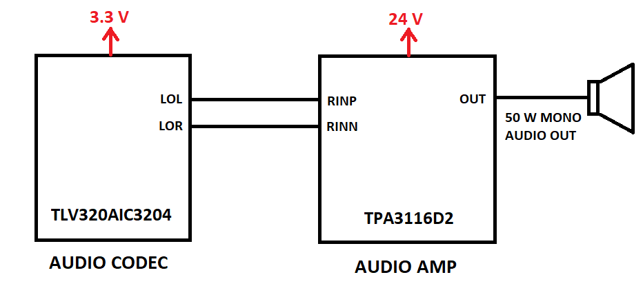

    1. I am planning to interface audio codec - TLV320AIC3204 to audio amp - TPA3116D2. Please refer the below reference block diagram. Can I interface this codec with TPA3116D2 in the below configuration? If yes, please clarify if the IO voltage levels of both the parts will match and will not cause any issue.
    If not, can you please suggest an audio codec suitable for interfacing with TPA3116D2 and required audio input is I2S microphone.
    2. If the above interface is correct, can the line out of the audio codec be directly connected to the audio amplifier or any signal amplifier should be used for this?

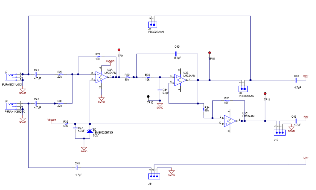

    In reference to the TPA3116D2 design - http://www.ti.com/lit/df/tidrd32/tidrd32.pdf, the input to TPA3116D2 is given through amplifiers as shown below.
    Please clarify the need for this amplifier at the input.

    1) The codec connection with TPA3116D2 is fine. BTW, most codec outputs are differential. if so, we suggest using differential input connection.
    2) Adding the low-pass filter to suppress the out-of band noise is important. The design you show to me is multiorder low pass filter.

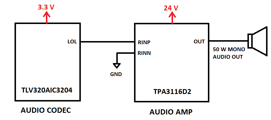

    1. For mono output, do I need to interface differential signal to TPA3116D2 from codec? If yes, does it mean that mono output do not depend on input type ( differential or single ended )?
    2. If 2.5V signal is provided as input to TPA3116D2, can it be amplified and will TPA3116D2 be able to produce 50W mono output?

    1) Yes, you can use differential input for momo design. It does not depend on input type.
    2)  Yes. The max gain is 36dB.

    2) For gain setting, no registers can be config, only use resistors. Please see the Table 1 in datasheet.

    1. Please find the image for the configuration mentioned in Q1 of my previous post.
    I have connected the LOL and LOR of codec ( TLV320AIC3204 ) to the RINP and RINN pins of TPA3116D2.

    1. The connection is fine. Do not add the input capacitors on TPA3116 input pins.

    1. Can you please clarify why coupling capacitor should not be connected to the input pins of TPA3116D2? Because in most of the reference circuits coupling capacitor is used after RC filter

    Sorry, That's mistake. I want to say: Do not forget to add the input capacitors on TPA3116 input pins.
    The Gain setting is related to the input signal level, this is system topic. You can adjust the gai setting by resistors, please refer the datasheet detail information.
