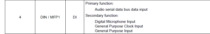

    1. Din should be connected to SDIN, not an output.
    2. A host processor is still necessary for communication with the CODEC.
    The TLV320AIC3204 does not have any internal class-D amplifiers so you would not be able to achieve 50W output. Also, these I2S mics are designed such that they do not require a CODEC. You can connect these mics directly to a host processor/digital input class-D amplifier. I can suggest you look at the TAS5755M or other TAS57XX family of digital input Class-D amplifiers. The TAS5755M is a digital input Class-D amplifier that accepts I2S input.

    1. Can you please explain Q1 in detail? Because Mic output should only be connected to the DIN - Digital Microphone Input as per below pin description. Please clarify this.

    1. What is the purpose of using the AIC3204 if your microphone already provides a I2S output?  if you don't need the ADC,  why not just use a DAC,  or a Digital input CLASS-D amplifier?
    2. The AIC3204 does accept the use of Digital microphones, however,  it is PDM output Digital microphones.  With the AIC3204 you would not have much flexibility in the signal routing.  The AIC3254 would allow you to have the Digital mic out on the I2S out,  while also sending the mic signal to the DAC. but with the AIC3204 your host processor would need to handle this (mixing the mic signal with any other audio)
    3. It is possible to use the AIC3204 with a I2S microphone,  however you would lose the ability to connect the processor to the DAC the I2S mic would be routed directly to the DAC Only.  This again begs the question... why use the AIC3204 when you don't need the functionality of the ADC? and you lose some functionality of the DAC.
