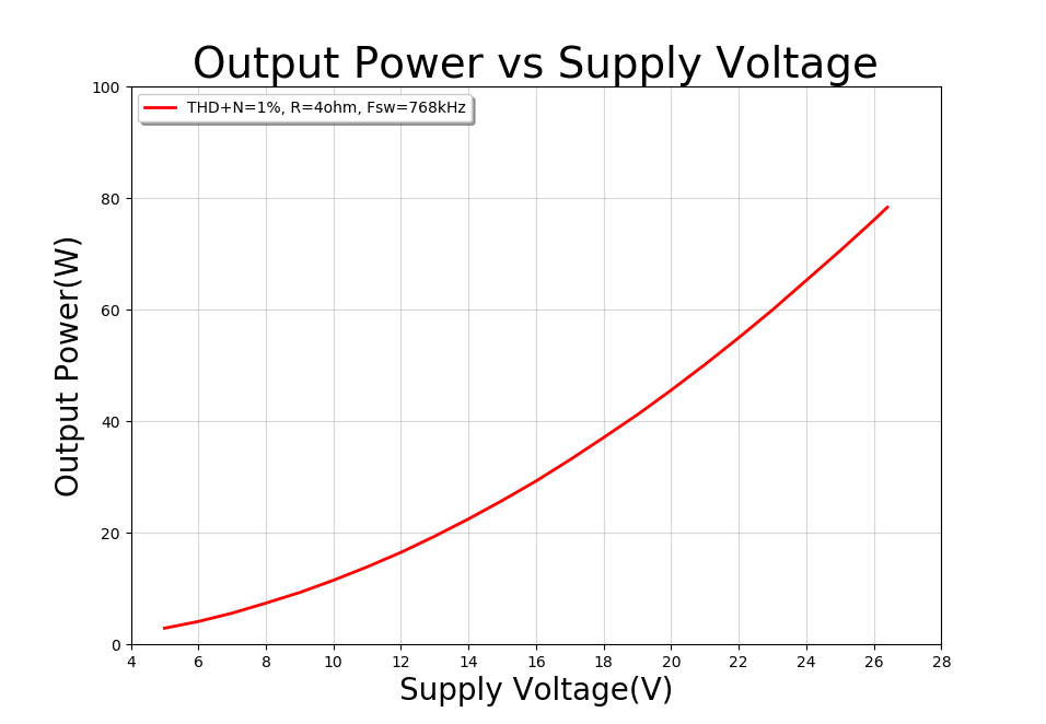

I received the following requests, could you assist?
• What is the maximum operating junction temperature?
• Is there a graph of the power supplied to the speaker based on the power supply voltage?
• What is the maximum current manageable for the speakers? 7A as indicated by OCETHRES or lower?
