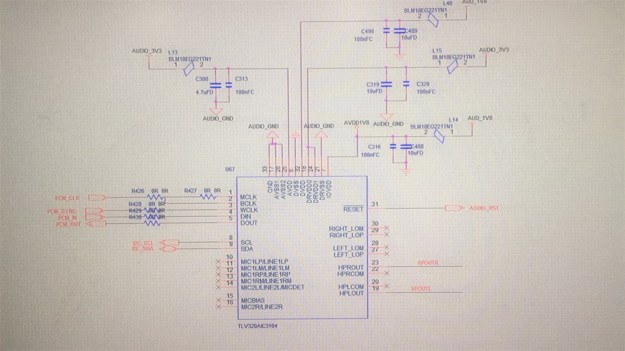

  dear
   customer use TLV320AIC3104+TDA2012,but output sound is very low
1.Before the test ,customer use wm8904+8 Ω speaker(Circle diameter<20mm),the perfomence is OK,
   Recently, customer use TLV320AIC3104+TDA2005, output sound  is very low and they consider  TDA2012 's gain is better than TDA2012,so they use TDA2012,but phenomenon  still
2.The supply power voltage is 3.3v and the voltage of G1/G2  pin is 3.1v, hige level, it is normal accroding to datasheet of TDA2012 ,which is high gain mode
3.Attachement is TLV320AIC3104  circuit
         Is there idea for solving this problem?Thanks  in advance~

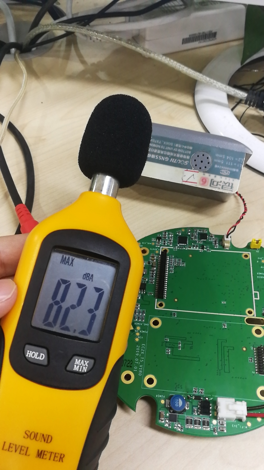

  • hello Aaron
    1. Is the customer trying to achieve stereo or mono output?
    mono has met performance requirement
    2. You mention that sound is very low at the output but what output is the customer wanting to configure? Also, are there any scope shots?
     it is a volume issue,  attachment show the sound level is 82.3dba,as a little louder  than we chat normally,customer wish it can be reach 90dba
    3. Is the customer wanting to use both Left  and Right DAC channels?
    customer just use one of them, now use left  DAC channels,it can be change to right  DAC channel if necessary
    4. What audio data interface is being used?
    PCM

    Looking at the register configurations, I see that the output common-mode voltage is being set to 1.35V. Since you are using 3.3V AVDD supply, I would recommend changing it to 1.65V.
    It also looks like the DAC_L1 path is being used to rout the signal to the HP outs. If no mixing is required, I would recommend using DAC_L3 as this channel has higher performance over the others. I hope this solves your issue.
    Aaron
  • hi Aaron
    1. recommend changing it to 1.65V. but phenomenon is still
    2.using DAC_L3,no sound at all
    3. Using the amixer regisister , the volume is louder than a human voice,will appear cracking voice, retrun to 80% volume will be OK, but can not meet volume requirement

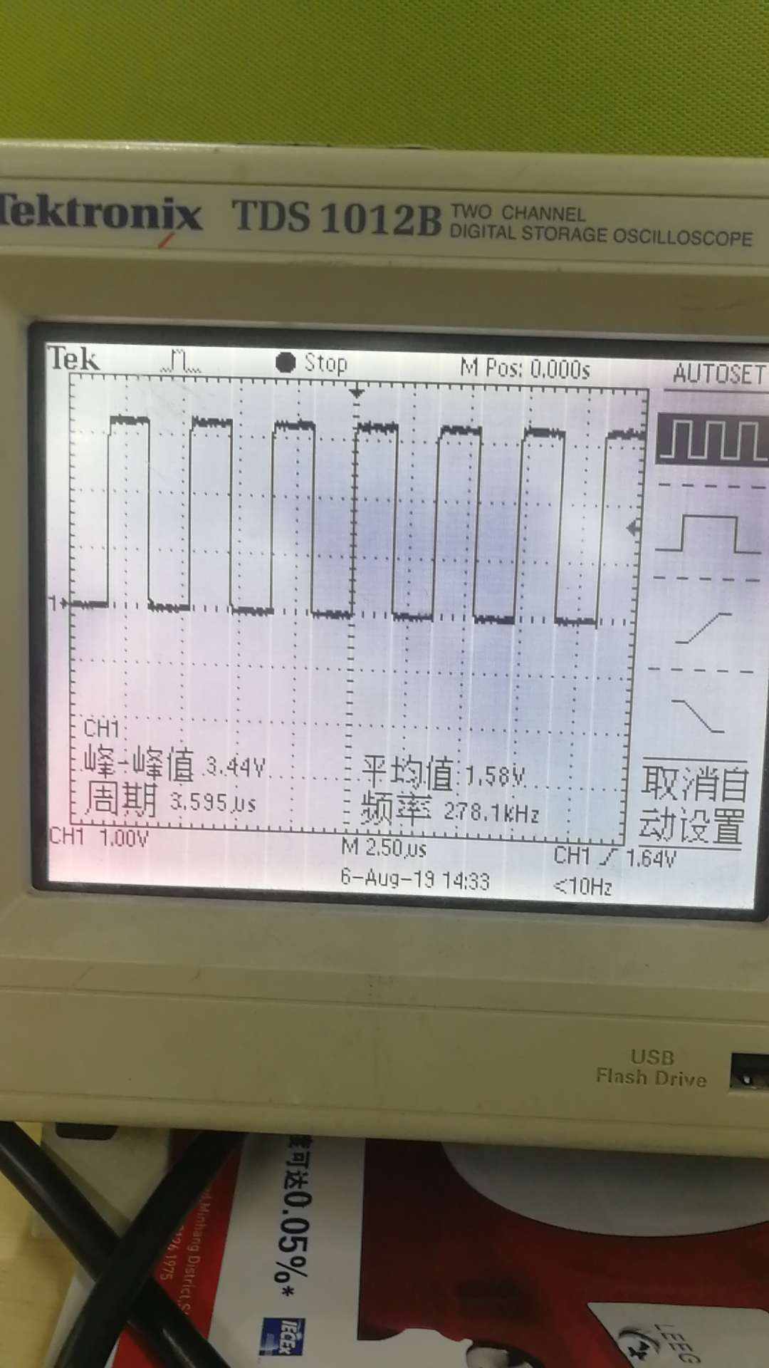

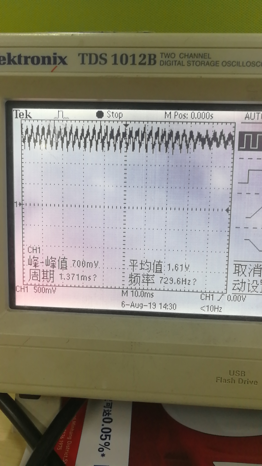

    attachment is tpa2012 output waveform and tlv320 output waveform,and tlv320 HPLCOM  pin connect to tpa2012 INL+ pin via cap
    HPLOUT  pin connect to tpa2012 INL- pin via cap
     any advise ?thanks advance

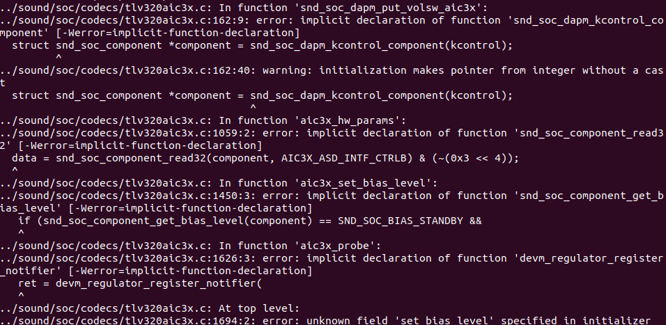

     Try routing DAC_L2 to the HP outputs is the same to L1 ,and customer download the dirver code from TI website like below,
    www.ti.com/.../TLV320AIC3XSW-LINUX
    but the compiler prompts for an error, core number 3.18.20  attachment is the error screenshot
