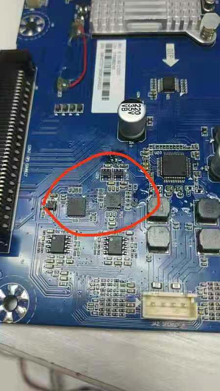

TLV320ADC3101: Could you kindly help to check schematic and the setting for getting sine wave.
Part Number: TLV320ADC3101
Dears:
delay_ms(100)
write(0x32, [0x00, 0x00])
write(0x32, [0x01, 0x01])
delay_ms(100)
write(0x32, [0x04, 0x00, 0x91, 0x08, 0x07, 0x80])
write(0x32, [0x12, 0x88, 0x82, 0x80])
write(0x32, [0x1B, 0x00])
write(0x32, [0x00, 0x01])
write(0x32, [0x33, 0x00])
write(0x32, [0x36, 0xB3])
write(0x32, [0x39, 0xB3])
write(0x32, [0x34, 0x3F])
write(0x32, [0x37, 0x3F])
write(0x32, [0x3B, 0x20, 0x20])
write(0x32, [0x51, 0xC2, 0x00])

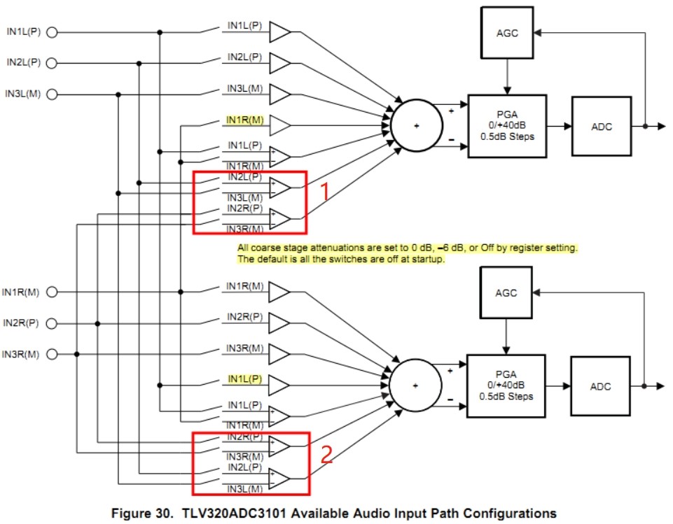

  • Hi Wilson:
    Thanks for your reply.
    How can we set the parameters if the signal path as below picture:
  • Luck,
    it looks like you want to have both differential inputs driving each ADC.  Are you sure you want to have the same inputs to both ADCs?
    best regards,
    -STeve Wilson
  • Hi Wilson:
    No need to have the same inputs to both ADCs.
    Thanks!

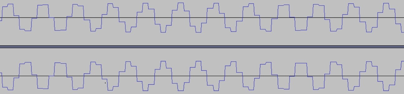

  • Hi Wilson:
    The wave is as below picture based the setting parameters.
    How can we get good wave? MCLK is 12M, sampling rate is 48K, 16 bits(IIS).
    And other issue is what are the allowable input voltages for PINs like 6, 7, 12 and 13? Do we use differential input, which allows input of - 1.5V ~ + 1.5V voltage?

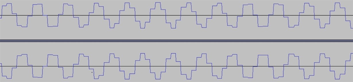

  • Hi Wilson:

  • Luck,
    is MCLK 12Mhz or 12.288Mhz?
    regarding input voltages, each pin has an absmax of Vss -0.3V to VDD +0.3V.
    Full scale input for this ADC is 0.707Vrms single ended or 1.414Vrms for differential.
