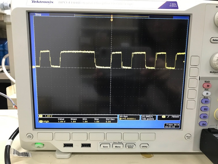

  • Thanks, Steve.
    It is very clear and understandable.
    I tried with the codec setting based on your recommendation.
    i) P=1, R=1, J.D=6.912, N=2, M=9, DOSR/AOSR=32, BCLK N=1
    ii) P=1, R=1, J.D=6.144, N=2, M=8, DOSR/AOSR=32, BCLK N=4
    I could see that wclk run 192kHz with oscilloscope in both cases.
    But HPL output is observed like below and it does not work.
    We configure the ADC channel for a differential electret microphone.
    (MIC --> CODEC IN3 -- I2S --> FPGA -- I2S --> CODEC HPL--> Power AMP(TPA3005D2) --> speaker)
    It seems when MIC input is active, power amp goes shutdown with the input from CODEC as below.
    They works well at 16kHz.
    When HPL output behave like below?
    Kazue Ozono
  • Ozono-san,
    1. Is it possible that the process flow uses components that are not available for FS=192k?
    2. can you share the process flow?  if you prefer to share privately please PM me.
