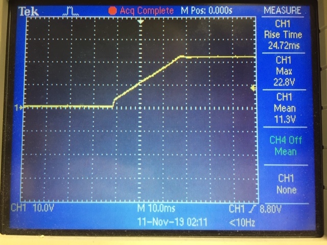

we operate the TPA3111 from a 21.6V rail. The SD-pin is connected via a 100k resistor to the 21.6V, as suggested by the datasheet and also the EVM.
However, the amplifier will not start and the SD-pin stays low, even when there is no connection with the FAULT pin. How much current is the SD pin sinking?
When I connect SD with the 3.3V rail, the amplifier works fine.
Is there power sequencing required?
