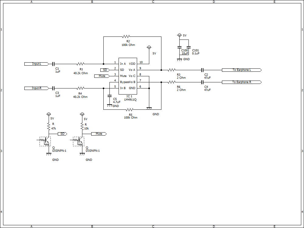

Hello , Please let me know about pop noise improvement.

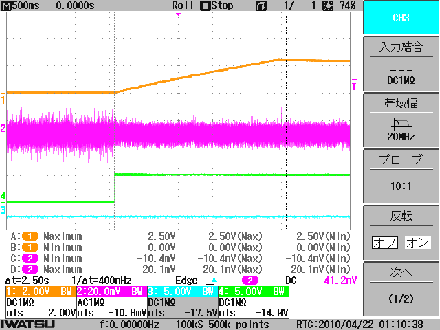

When SD switches from "L" to "H", Pop noise occurs after about 2.5 sec from SD "H".
It is same timing with charging is completed of Cbypass.
CH1: Cbypass(C5), CH2:Output (To Earphone L) CH3: SD CH4: Mute
How to improve this pop noise?
