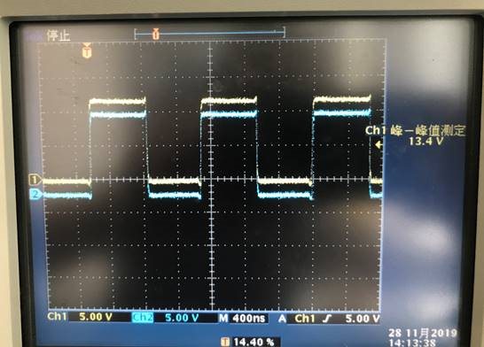

customer found that on their board, when the volum lower than -60dB, we can hear the pop sound. With the volum goes up, the pop sound will gradually disapper. the noise not amplified with the volum increase.
1. Check the output PWM on the customer board, the waveform as below, didn't find the any noise and jitter  at -60dB.
2. With the different audio source, can heard the pop on the customer board.
3. Use the customer 's .cfg file on the TAS5805M EVM,can't heard the pop.
I found that the different between customer board and EVM is that, in the customer board, there is no PWM output when no sound play while in the EVM there has the 50% duty-cycle PWM output always. Does this affact pop?
