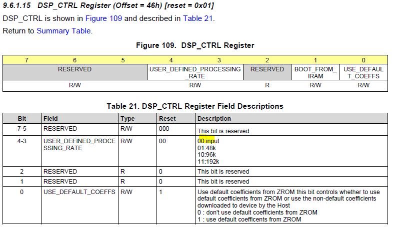

Hi Sirs,
Can we write 0x46 = 0x01 for every TAS5825 projects to support 32kHz sample rate? Any side effect?

Hello Wayne,
In our PPC3 GUI, you can choose "As input" to adjust for different sampling rate. For SRC module, "As input" can support 32, 48/44.1, 88.2/96 and 192KHz.
But it is suggested to choose the process flow and set that in process flow.
Alix Wan.
