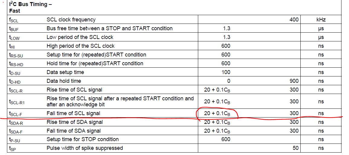

I want to know the definition of tscl_F and CB shown in the datasheet.
According to my measurement, the falling time of I2C CLK is only 5.2ns, much smaller than the tscl_F, would you kindly explain it here.

HI Shubiao,
Do you see any riisk for I2C communication? Please describe this issue in detail.
TAS5805M is the slave of I2C bus, hence, we cannot decide the fall time of SCL signal. But our spec is as you see in the datasheet.
5.2ns is faster than our spec, for this situation, usually, TI recommend to follow our spec.
