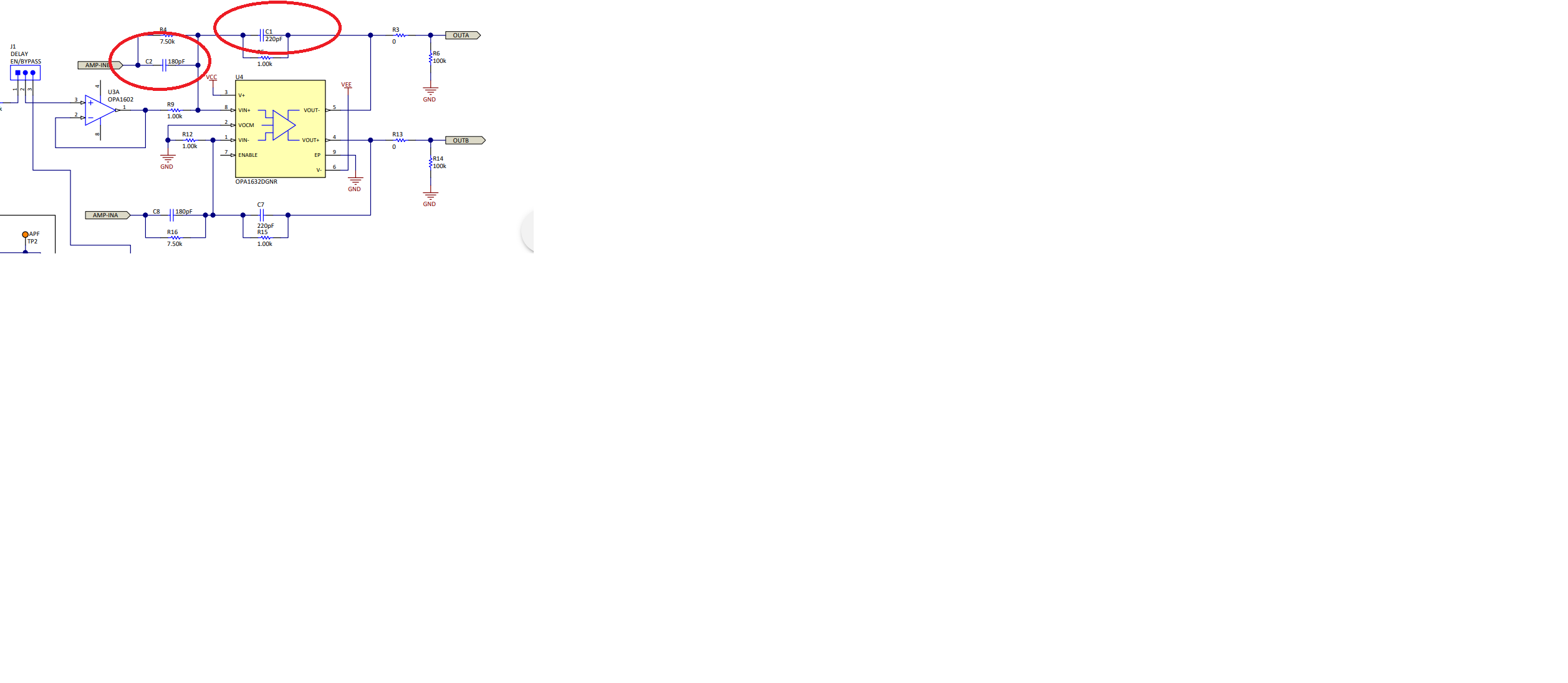

What is the usage of C1 and C2 on Page 17 about <<Analog Crossover Audio Plug-In Module>> application notes , C1 parallel with feedback resistor is compensation capacitor , what about C2?
Hello Kailyn,
This seems to be briefly mentioned in the datasheet (page 5 AMP-INA, AMP-INB). That part of the schematic is for additional post-filtering after the connection is made with the Class-D Amplifier EVM via the Analog Crossover Audio Plug-In Module. The type of filtering looks to be an all-pass filter incorporating a high pass filter at the non-inverting input of the amplifier.
