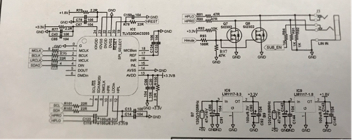

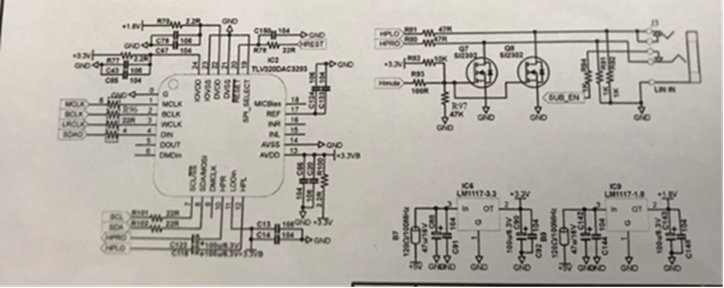

it’s about TLV320DAC3203 pop noise when power up and power down, TLV320DAC3203 is set as SE output, 16Ω headphone load, use external AVDD, below is TLV320DAC3203 SCH.

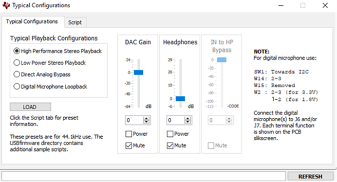

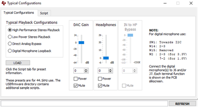

Before power down, we mute and power down DAC and headphones as below, and headphone output has no output. Next, we power down board, output has a clear pop noise. And get the same results when test on the TLV320DAC3203demo
Eliminate the effects of components, we use 47uF Ceramic capacitor replace with 100uF electrolytic capacitor, remove components behand HPLO and HPRO, tied headphone output directly after DC blocking capacitor. Set TLV320DAC3203 the same as above setting, headphone output still has a clear pop noise when power up and power down.
Now we add Q7 and Q8 MOSFET pull output to GND to decrease pop noise when power up and power down. And we want to know: when TLV320DAC3203 set as SE output, if pop noise cannot eliminate due to DC block capacitor’s influence. And must need external mute function.
  • Hi Yuan,
    Pop noise performance is very dependent on the load connected at the outputs. Section 4.2 from the reference guide was created using a pair of 16-ohm loads and observed on the scope, not actual speakers with SPL measurements or hearing test.
    It is a good approach to use external transistors to eliminate pop if the available settings are not completely eliminating the transients.
    -Ivan Salazar
