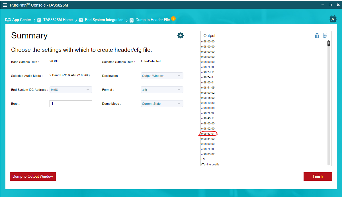

  • Hi Scott,
    TAS5825M DC Offset ATE trim is based on 'in phase' setting to implement good performance with BD/1SPW/Hybrid mode, so 'Out of Phase' BD setting has worse DC offset, which cause larger pop noise.
    Considering inductor filter with TAS5825M has enough EMI margin, so our PPC3 dump out script already configured as 'in phase' as below. It's suggested to follow our recommendations.
