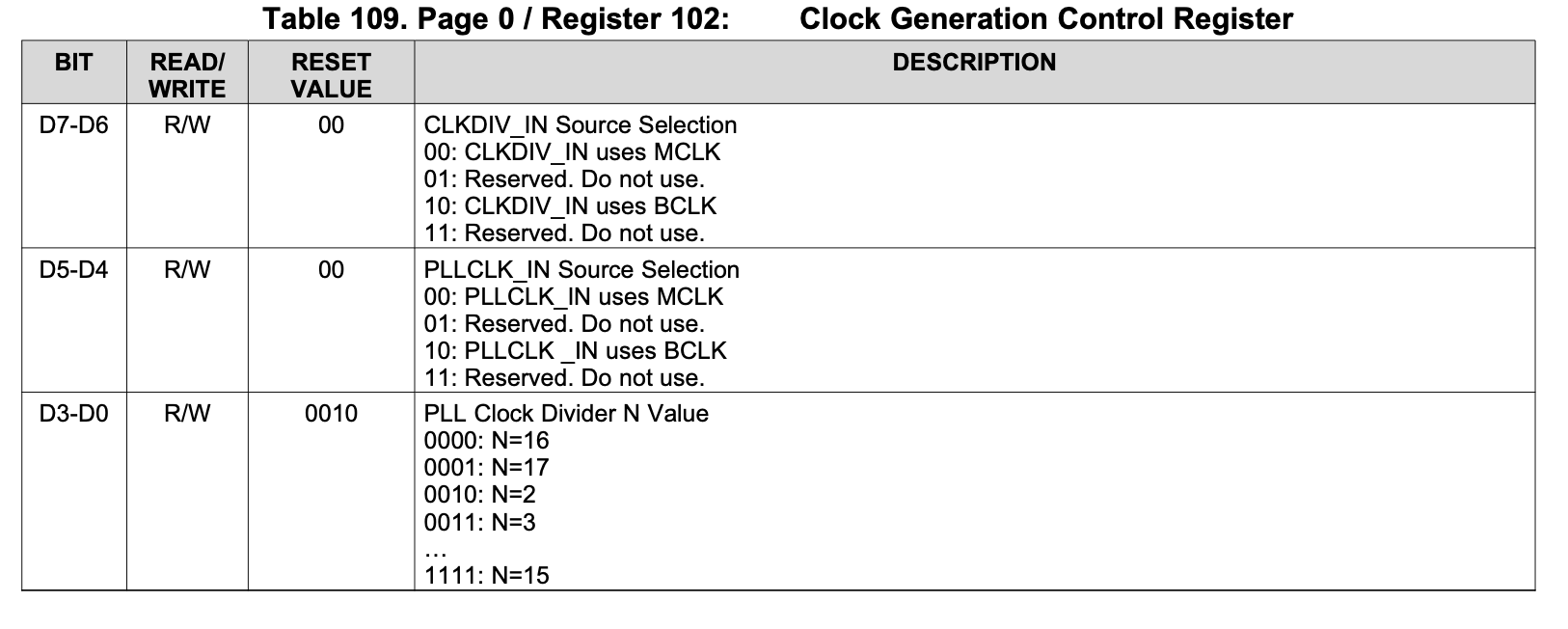

I have the EVM wired up to our board and the I2C and I2S look good on the scope but it doesn’t play sound out a speaker or headset. I am using the EVM without the USB expansion board. Intel seems to believe that it requires a Master Clock signal from the CPU for the codec to function. From the following diagram from the datasheet, I assume you can use either a bit clock or a master clock for the I2S bus.
Can you confirm it can use the Bit Clock(BCLK) or does it require a master clock(MCLK)? Is there a register I need to set in order to choose which clock the system should use?

    When using the EVM with the USB-MOD-EVM controller we operate the device in 4-wire mode.  However, as you've noted the PLL can be used to convert the BCLK input into a valid internal MCLK.  This is confirmed in the datasheet text below the image you've attached:
    The part can accept an MCLK input from 512 kHz to 50 MHz, which can then be passed through either a programmable divider or a PLL, to get the proper internal audio master clock needed by the part. The BCLK input can also be used to generate the internal audio master clock.

  • Can you please confirm the register (Table 109. Page 0 / Register 102: RESET VALUE Clock Generation Control Register from the Datasheet) is the correct register that sets the internal clock from MCLK to BCLK?
    Are there other registers I need to be concerned with changing to get the codec working?

  • Hello Lindsey,
    Yes, Register 102 will allow the user to select either MCLK or BCLK as CLKDIV or PLL_CLKIN. You want to also make sure that the CODEC_CLKIN source is correct. This is determined in register 101.

  • Lindsey,
    The reset value for register 102 is correct,  however if you are not providing any input to the MCLK pin,  You need to also assign the BCLK to the CLK_DIV input (even if you are not using it)
    So register 102 would need to be configured as 0xA2
