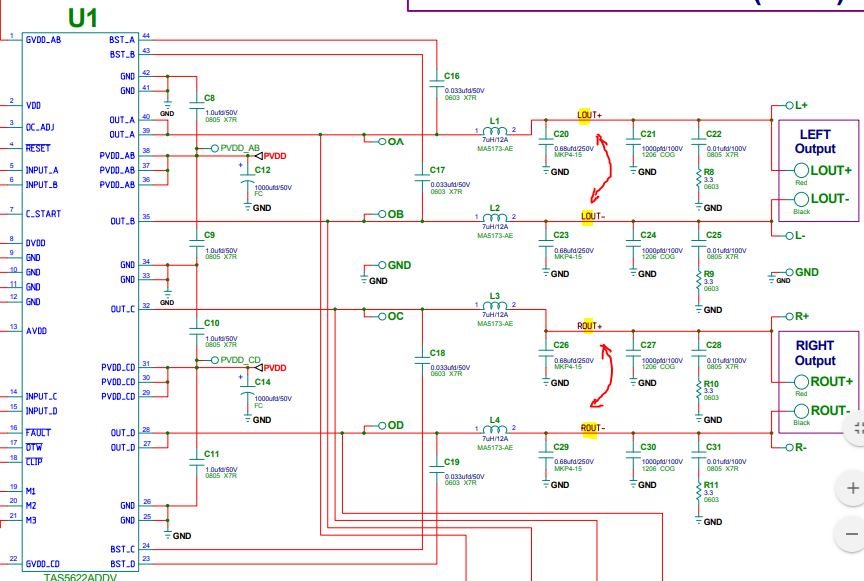

Hi Sirs,
As title, the reference design of the TAS5624A specifies the OUT_A as PWM_L(+), OUT_B as PWM_L(-), OUT_C as PWM_R(+) and OUT_D as PWM_R(-) in BTL mode.
Would you please advise if we can swap the polarity of the output to assign OUT_A to PWM_L(-) or OUT_C as (PWM_R-) in BTL mode?
