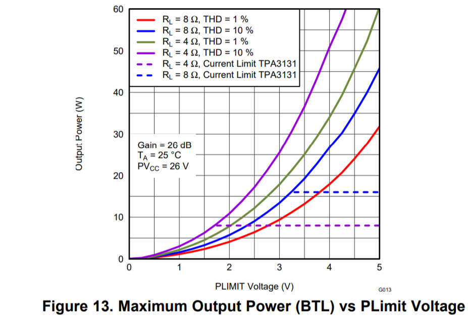

We would like to check if TPA3131D2 can be used on 10W output condition.
Kuramochi
