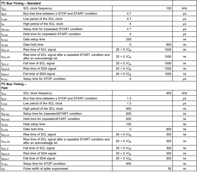

When is the I2C slave address locked in? Can you provide some timing guidance?
Is there any 'settling time' after power-on, before the address is latched by the ADC inside the part?
Thanks!
Hello Jatan,
The I2C timing characteristics for the TAS5805M can be found on Page 9 of the datasheet.
All the best,
Carolina
Carolina,
Thanks for the response!
Which of those numbers would correspond to the I2C address latch time? Is it the 4.7usec setup time?
Hi JatanNaik,
TAS5805M I2C address detection happens ~200us behind PDNz pull high.
Matthew
