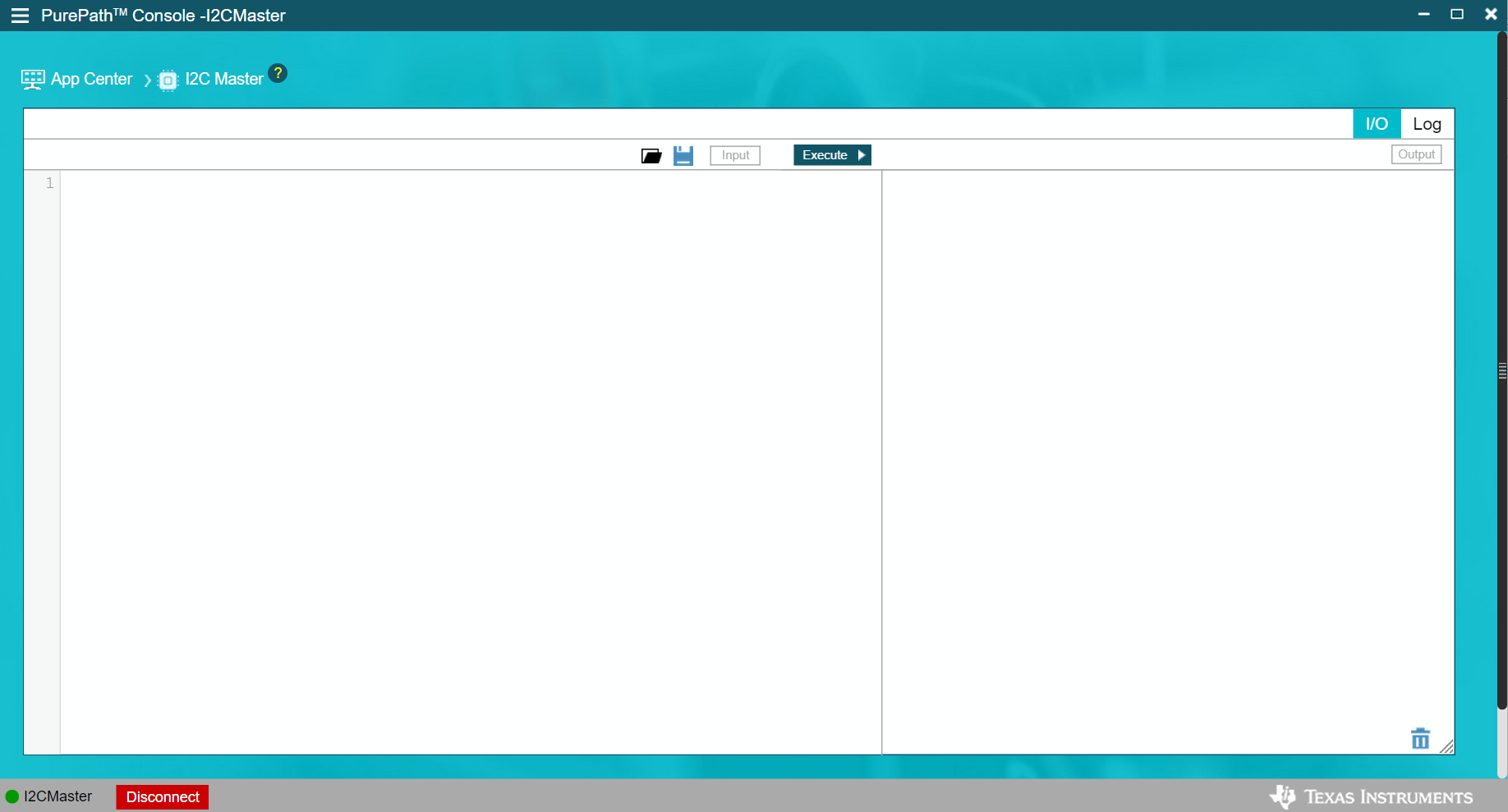

TAS5825MEVM-SB: Where can I get the code.txt which into the I2C Master app?
Part Number: TAS5825MEVM-SB
Hello

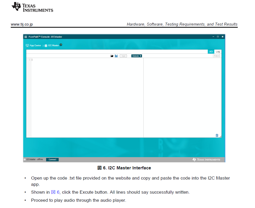

I try to start TAS5825MEVM-SB connected PPC Motherboard according to the user guide.
In page 9, there is no code.txt in the I2C Master app also my PC.
And I couldn't find it on the website.
And I just downloaded  TAS5825 Software, but I still don't use it.
Please Help.
Yuriko
  • Hello Yuriko-san,
    I had thought that the .txt file was uploaded to the site. While we get this straightened out I've attached the file here. Let me know if anything else arises.
