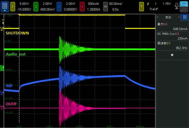

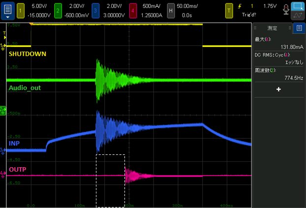

My customer have an issue about TPA2000D1 output.
Please refer the attached waveforms.
it seems, not output from amplifier at the timing recovery from shutdown.
They tried to repeat Shutdown pin High and low.  it has NG case and OK case. It seems depend on INP pin status at startup.
(NG case)
(OK case)
Q1, Could you please give me your advice for this issue?
Q2, Could you please let me know the delay time between Shutdown pin High and the amplifier normal output?
Q3, Could you please let me know the difference of internal behavior between NG case and OK case?

     >>Do you notice another difference between the NG device and OK device? I mean, is there any difference in the power supply level, inputs, shutdown rise time, etc.?
    >>What percentage of failures do you have?
    They don't find any difference other than INP rising timing.
    Both NG case and OK case was tested by same board. customer believe the difference is only INP rising timing. If it have some delay between Shutdown Pin to INP raising time, it became NG behavior(100% Reproducible).
    They are doing the repeat test of shutdown pin ON/OFF, it might be depend on INP discharge.
    Muk
