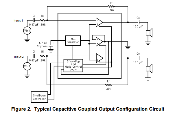

The TLV320AIC3109-Q1 has low output power of 15mW when connected to a 32-ohm headphone. The customer would like to increase the output by connecting to LM4911Q-Q1. Are these two devices compatible? What are the passive components that needs to be added between the output of TLV320AIC3109-Q1 and input of LM4911Q-Q1? The application is mono.
