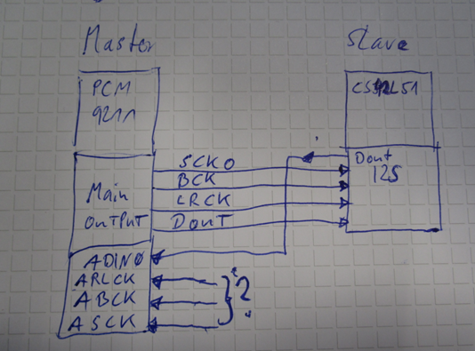

I would like to connect the PCM9211 via I2S with the CS42L51 device.
The CS42L51 has a classic I2S port as I know it:
Master clock
Bitclock
LR-Clock
Dout
Din
However, the PCM 9211 provides separate interfaces for PCM data, i.e. AUX in (I2S in) and Aux out (I2S out).
Where do the clocks for the AUX in on the PCM9211 come from?
Do they have to be connected to the clock lines of the main out?
