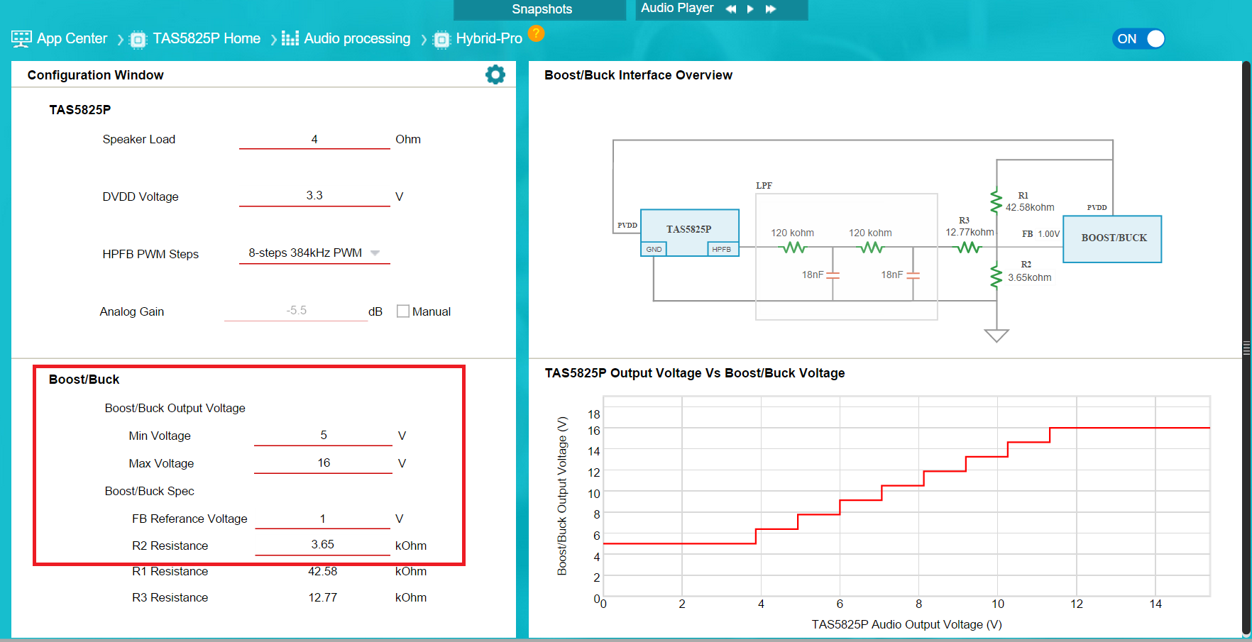

Q1. The datasheet said the PVDD should be similar as possible to the EVM design and the EVM uses LM5155 as a DC/DC converter for PVDD. Is it possible to use another DC/DC including competitor device?

           About Q1, It’s OK for using other BOOST or DC-DC converter, you can input related BOOST parameters into TAS5825P PPC3 and get the feedback res values. You need to input Min/Max output voltage/ DC-DC FB reference voltage /R2 feedback res value, and Software will give other results. But we would suggest customer use our DC-DC products for  better performance and easier debug.
            About Q2, HPFB is one PWM format signal, which modulates audio signal level information to control real time DC/DC output.
