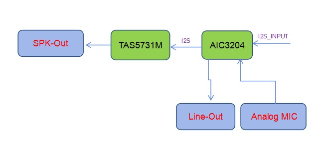

Our project need to implement a function,want to mix the Line-in with I2S data and then out to I2S_output and HP_out,the diagram shows attach.Can AIC3204 Support it?how to get the driver?
thanks!

Oasis,
The AIC3204 cannot support this function, they would need to use the AIC3254 which has a programmable MiniDSP. The miniDSP would allow them to mix the I2S In with the Decimation filter output (ADC IN), as well as perform other processing. The AIC3204 is similar to the AIC3254 but it has a fixed function DSP with set processing blocks described in the Applications reference guide. none of the processing blocks support digitally mixing of I2S input with the ADC input.
