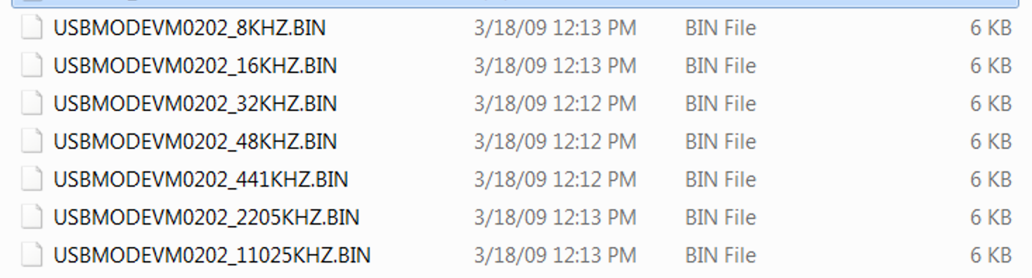

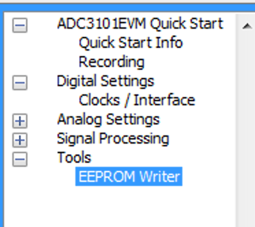

    If you are wanting to test the device using the usb audio processor, then you do need to reprogram the EEPROM that holds the USB audio firmware. this can be done with the GUI by going to Tools/EEPROM Writer
    once you click EEPROM Writer,  click on the file browser icon (see below) and browse to the USBaudio firmware folder.  the path is
    C:\Program Files (x86)\Texas Instruments\ADC3101 CS\USBfirmware\image
    The available usb audio sampling rates are shown below:
