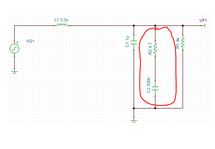

  • Hi Ferhan,
    For your application, the impedance of speaker is about 15ohm, right? The output power is about 7.5W, right?
    If you need to pass EMI, you need to add 10uH inductors on outputs.
    If you do not need to pass EMI, AMP can drive the speaker directly without inductors.
    I still suggest you add snubber for the high-impedance speaker. The snubber circuit (4.7ohm+330nF) is attahced.
  • Dear Derek , One of the speaker was 15 ohm and 7.5 Watt. We want to  add 4 pcs to 6 pcs in parallel , that makes about 3.75 ohm with 4 speakers and 30 watts in total.
    is there a guideline that will help us  designing snubber circuit values according to the power on the output?

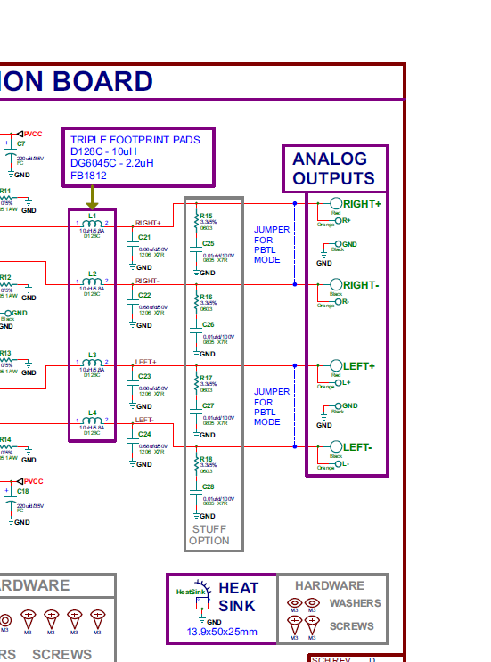

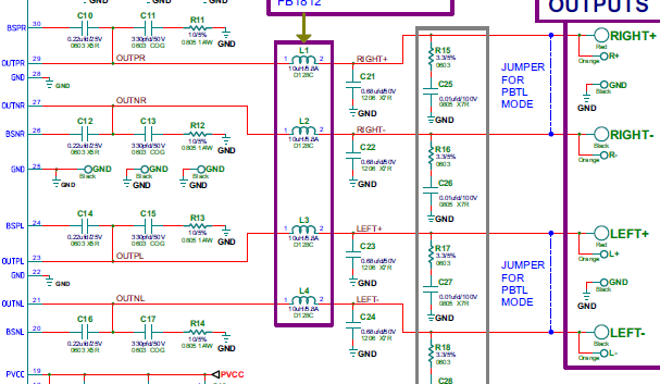

    To understand it clear, from the evaluation board below;
    I already have the L1 and L2 10 uH inductors that is connected to the OUTPR and OUTPL , Are we talking about these inductor or adding another one on the output before the speaker connection?
    We have  0.68 uF capacitors C21 to the ground as adviced on the TPA 3116d2 evaluation board like your C1 . Also the R15 and C25 were added which the values will be corrected according to the new load snubber circuit update ( 3.75 ohm , 30 Watt). We also need to add  a 4K resistor tp GND?

  • Hi Ferhan,
    Yes, the inductors L1 and L2 in EVM are the inductors we talking about.

  • Dear Derek.
    I hope that you are doing well,
    In the original attached below 3116D2 EVM , you can see the jumper (shorting of outputs) on the  Left and Right Side of the Amplifier with Blue tags. Our design is now operating both BTL and PBTL according to our selection now. so my question is i have 2 pcs of 10 uH inductors on OUTPR and OUTNR  for Right side and the same for Left side respectively, and also the snubber capacitors in each line  now,  i am shorting the outputs with  relay contacts  on the PBTL mode as in the picture. Is this type of operation allowed in PBTL Mode having 2 inductors and all the capacitors still connected for BTL mode?
    Thank you
  • Hi Ferhan,
    2 inductors and all the capacitors are fine for PBTL mode.
