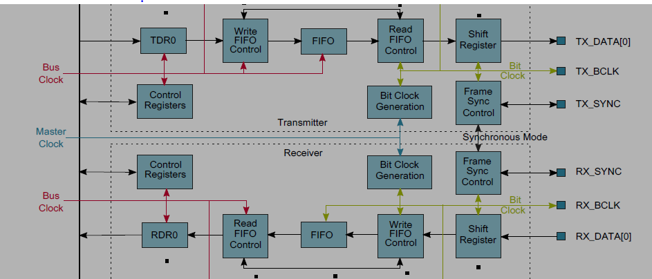

    Thanks for the reply... My query is we are interfacing this TAS2770 device to a processor on SAI port.
    So we connect
    TAS2770           uP
    SDIN -             TXD
    SDOUT -          RXD
    SBCLK -          TXC
    FSYNC -         TXFS
    So is there any need of D-Flip Flop between processor and TAS2770 in consideration of TXFS signal.
    Because we are physically interfacing TDM & then configure I2S.

  • Hi, Shubham,
    Could you provide details about the SAI port protocols? Also, could you provide the data format that is used by this port? This is just to verify if it is compatible with the TAS2770.

  • Hello Luis,
    Please find the below SAI port details, Suggest the interface compatibility.
    Features from the processor side
    Transmitter with independent bit clock and frame sync supporting 8 data lines
    • Receiver with independent bit clock and frame sync supporting 8 data lines
    • Each data line can support a maximum Frame size of 32 words
    • Word size of between 8-bits and 32-bits
    • Word size configured separately for first word and remaining words in frame
    • Asynchronous 128 x 32-bit FIFO for each transmit and receive data line
    • Supports graceful restart after FIFO error
    • Supports automatic restart after FIFO error without software intervention
    • Supports packing of 8-bit and 16-bit data into each 32-bit FIFO word
    • Supports combining multiple data line FIFOs into single data line FIFO
    • Independent 32-bit timestamp counters and bit counters for monitoring transmit and
    receive progress

  • Hi, Shubham,
    Thank you for sharing the details on the SAI port. I don't see any issue on the port compatibility, the TAS2770 supports the different data, I think the 8-bit data is the only format that is not supported, but the rest of the configuration can apply to the TAS2770 interface.
