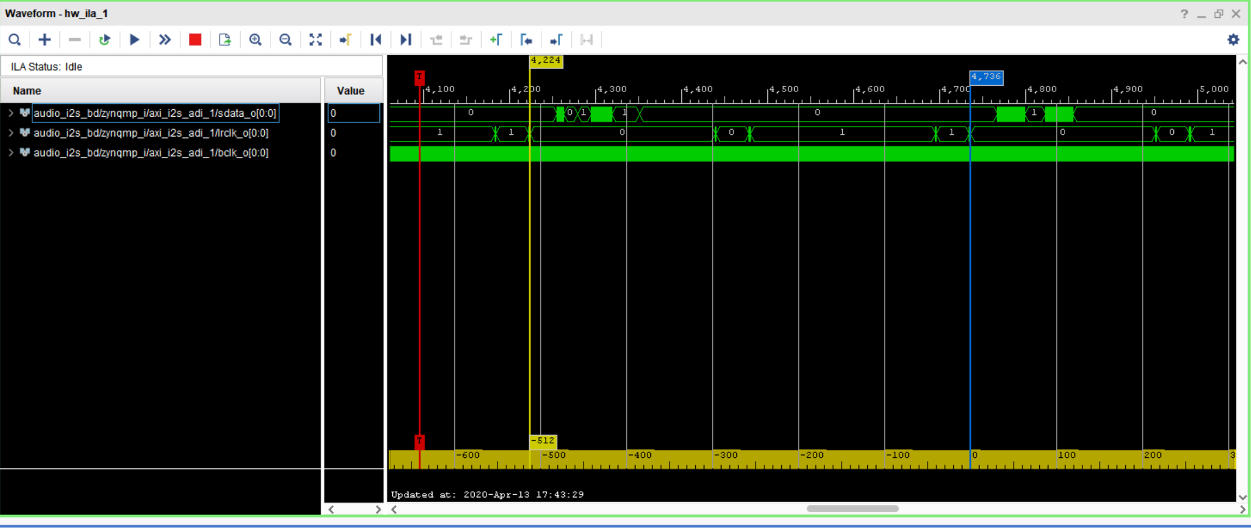

  • Aaron,
    Here is a logic analyzer wave capture for the bclk and wclk. I am actually not quite sure the frequency of the bclk and wclk, I will have to get back to you tomorrow. I know the i2s ip core is getting configured when launching aplay, etc.

    I have used the same routing paths here on an EVM and verified that it should work. I do notice that there are a lot of writes to unnecessary registers. For example. 0x2f is being written to a lot of the routing registers that aren't being used. If registers aren't being used, please keep them at default configuration.
    Looking at the picture showing the CLKs, it looks like LRCLK is not 50% duty cycle. Can  you confirm this? If using I2S, LRCLK should be at 50% duty cycle.
