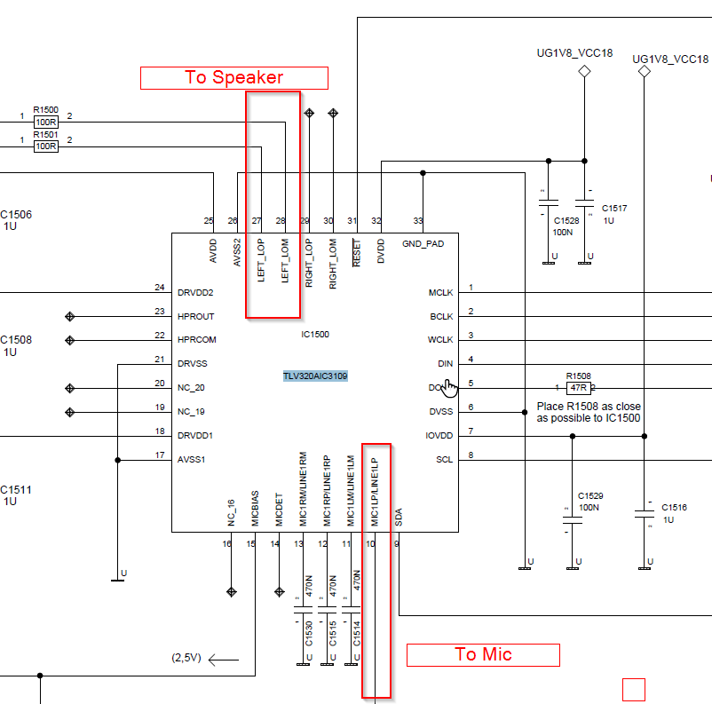

We are using the TLV320AIC3109-Q1 Codec with above mic and speaker connection. The Codec is Connected to SOC over I2S. I2S is configured in left Justified.

We are observing few issues with the above settings.
1) The microphone does not work when the registers 22 and 24 are programmed with reserved values. The Mic works only when programmed with values for register 22 -> 0x07 , 24 -> 0x00 , 16 -> 0x00
2) When the above values are programmed we observe there microphone is having noise. (Attached the audio file for reference)

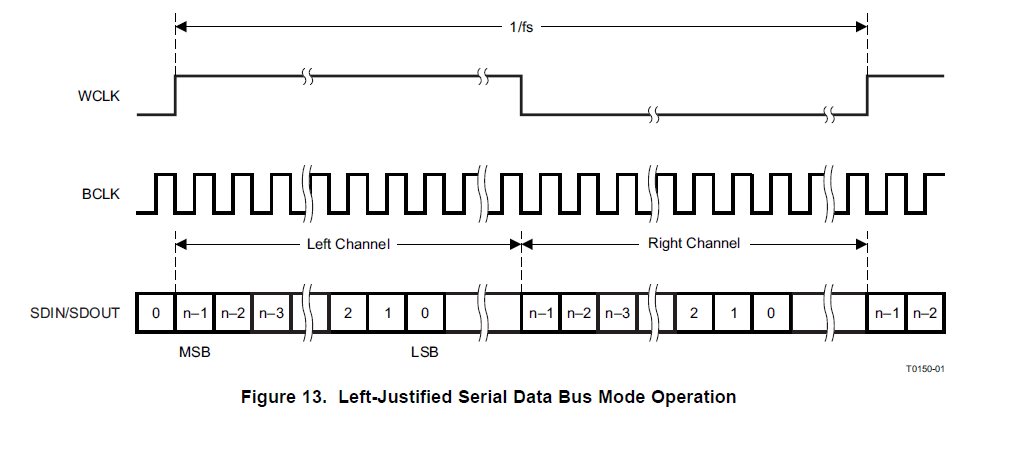

  • Hello Bharat,
    Apologies for the delay in response.
    It looks like the WCLK and BCLK edges are not sync'd correctly. The image below shows how the WCLK and BCLK edges should be synced in Left Justified. The edges of WCLK should be synced with the falling edge of BCLK.
    Aaron
