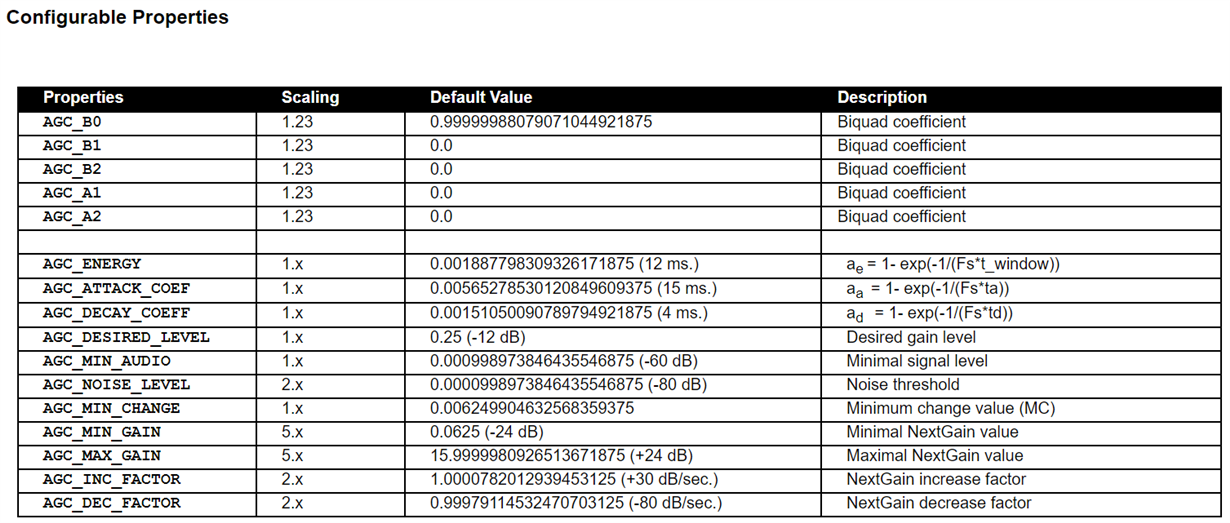

Hi all,
I am working on TLV320AIC3120 custom board. For audio processing I am using Pure path studio. In that I am interested to use dynamic processing block AGC provided after mic input. But in the help file of AGC explanation about configurable properties not enough to calculate parameters according to my application requirements. So is there any resource available where I can look into to gain some more information about it?
Let me know.
Krushna Manjarekar.
AGC paramters  from help file :
Process flow diagram :
