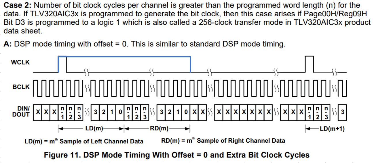

TLV320AIC34: WCLK on DSP mode
Part Number: TLV320AIC34
Is the WCLK of the following blue line allowed on DSP mode?
I could not find the specification of the WCLK width.
I'm referring to the following application note.
http://www.ti.com/lit/an/slaa311/slaa311.pdf?ts=1588256301845
Kuramochi
  • Kuramochi-san,
    The WCLK should be the width of one BCLK period.  Other codecs in our portfolio are a little more flexible on this, using only the rising edge of WCLK to mark the frame, the AIC310x and AIC34 devices are more strict.
