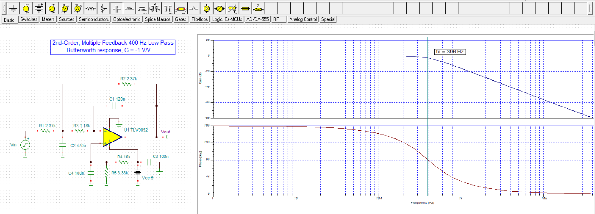

Customer is looking for a low pass filter circuits with amplifier before their 2.1 channel audio amplifier. Could you please help suggest a dual channel amplifier using 5V and the related low pass filter circuits? Thank you.

Hi Thomas,
The cut off frequency is 400Hz. They are trying to use TLV9052 for the low pass filter design. Are there any reference circuits? Thank you.

I used a filter design program to synthesize a 2nd-order, 400 Hz low-pass filter having a maximally flat Butterworth response. Once the circuit component values were determined I set the filter circuit up in Tina-TI to check the frequency response. You can see the resulting filter circuit and response obtained from TINA-TI here:
Using standard value passive components the cutoff frequency is 396 Hz. I set up the voltage on the TLV9052 non-inverting input so that the output voltage is centered at +2.5 V. That maximizes the linear output voltage swing range.

Hello Aki,
I have prepared the LPF circuits in Fc=400Hz @Q=0.707(Butterworth) with both single-ended output and differential output.
While, I chose MFB topology due to THD.
