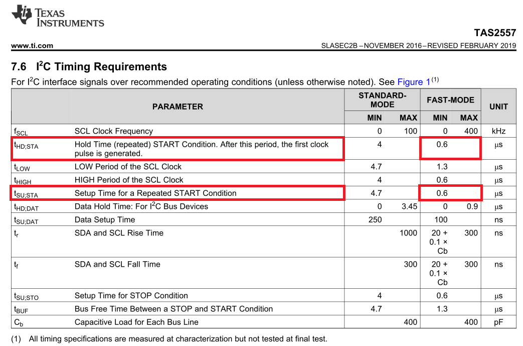

According to TAS2505 data sheet, the minimum values of tHD;STA and tSU;STA are 0.8us for the fast mode. On the other hand, those values are 0.6us in TAS2557 data sheet.
Then, those values are 0.6us when checking the I2C bus specifications.
Are those values which are mentioned in TAS2505 data sheet typos?
