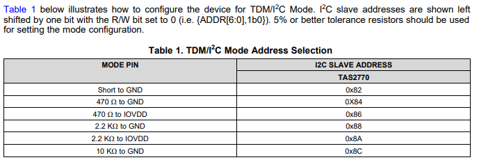

  • Hi Jin,
    I'm using this to drive an actuator coil for a robotics application.
    I've been struggling to interface with the TAS2770 EVM with an external microcontroller over I2C (I was able to play audio successfully over PPC3, but need an external microcontroller for my application).
    On my EVM, I have the following jumper settings:
    • J2 - connected
    • J6 - connected
    • J11 - all open
    • J13 - I2C address set to 0x82
    • J21, J22, J18 - connected
    • J12 - connected
    I have a very simple Arduino sketch that tests communication on a bunch of I2C addresses, and reports back on the addresses that it was able to reach successfully.
    Here's the relevant code snippet:
    Wire.begin();
    Wire.setClock(100000);
    for(int address=0x00; address < 0x8e; address++){
        Wire.beginTransmission(address);
        error = Wire.endTransmission();
        if (error == 0) {
          Serial.print(F("Device found at address 0x"));
          if (address < 16) {
            Serial.print("0");
          Serial.println(address,HEX);
        delay(50);
    However, I only see I2C addresses 0x41 and 0x42 appear, regardless of J13's settings (the addresses disappear if I disconnect J6 or J12 I2C-SEL). I'm confused why 0x41 and 0x42 appear, rather than 0x82. I've verified that my SCL and SDA I2C signals are being transmitted correctly from my microcontroller with an oscilloscope. Any explanation for this?
    What steps need to be taken in order to communicate over a microcontroller I2C to the TAS2770 EVM?
    Chris
  • Hello Chris,
    That is a great question. Have you tried addressing 0x41 and 0x42? Did that work for you? I2C address 0x41 and 0x82 are in fact equivalent. 0x41 is the 7 bit I2C address, the datasheet just left shifted by one bit for the R/W bit. Also, you may need to restart the board when there is an I2C address change for the device to adjust during power-up.
    External I2C control is specified in TAS2770 EVM User's Guide. Your setup looks fine to me, but you can verify it for quick reference. One thing to note is that make sure J1 is set to the voltage level of your external device's logic level.
    In addition, following up to a related thread from you. TAS2770 has a default High Pass Filter built in, you might want to consider bypass that if you want to test the  DC output to your actuator.
    Let me know if you need anything else.
    Jin Gao
