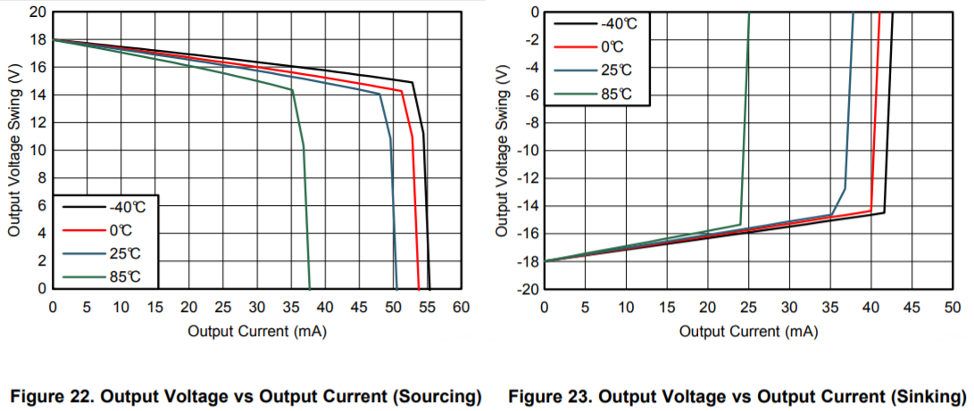

My customer is looking for the Output Current at 1V drop. We are looking in the datasheet and couldn't find this information.

Would you shared the schematic with us? Below are figures for source and sink current at 4 different temperature. You have to provide at least two parameters to find out the third --> e.g. Voltage Drop and Load impedance in order to find to find out the output current, or Voltage Drop and load Current to find out the load impedance. Temperature is another variable per the figures.
