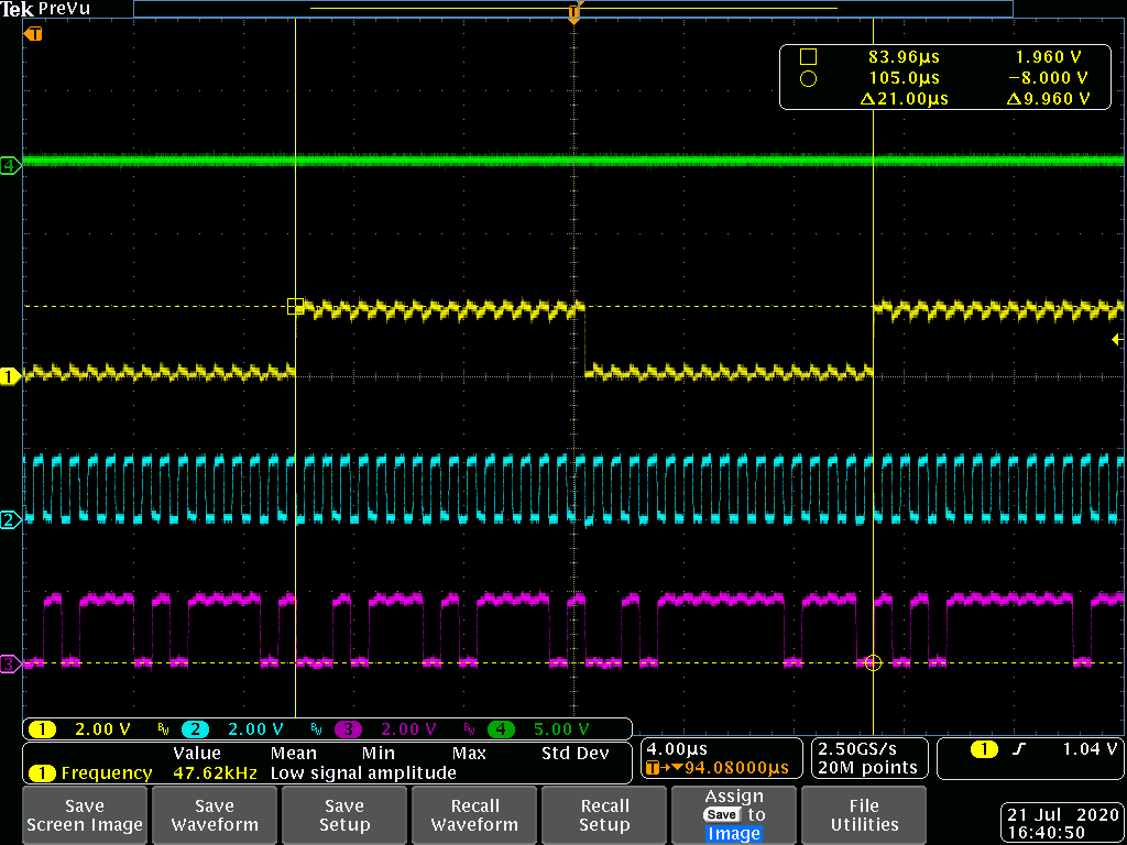

We have a TAS2770 audio amplifier connected to the I2s output of a Nordic Nrf52832 µC.
But nothing on loudspeaker output (in green on the attached scope screen)
I've configured the Nrf52 and can see I2S signal (yellow for FSYNC, blue for LBCLK, and purple for SDIN).

The register 0x77 is read at 0x17, so FS_RATE_V = error condition. Why do I have this fault? How is it triggered?

    With correct slot channel, I have a signal on the speaker output.
    For it to work properly, I must first send the I2S signal before activating the amplifier with register 0x02. when I do the reverse, there is nothing on output.
    Eric
  • Hello Eric,
    The procedure seems correct. I2S must be present before the device is enabled. If there is no clock input, the device will disable itself due to clock error. A proper procedure should be along the line of power the supply -> initialize and power up the device -> enable the device. You can initialize the the device without the clock, but the device should still be enabled last.
