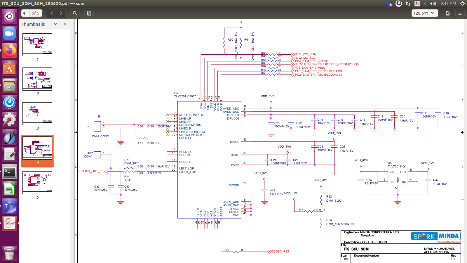

  • Hello Aarong,
    Currently we are not using LINE1L and LINE1R lines for speaker.We have connected speaker to RIGHT_LOP line.Please have a look on below schematic for more details.
  • Hello Prasanth,
    It looks as though the PLL is still not configured correctly. Register 4 should read 0x20 to set J = 6. For D = 600, register 5 should be 0x09 and register 6 should be 0x60.
    Can you also please probe BCLK, WCLK, MCLK, and DIN? Can you also measure the RIGHT_LOP pin and see if you are seeing a DC voltage?
