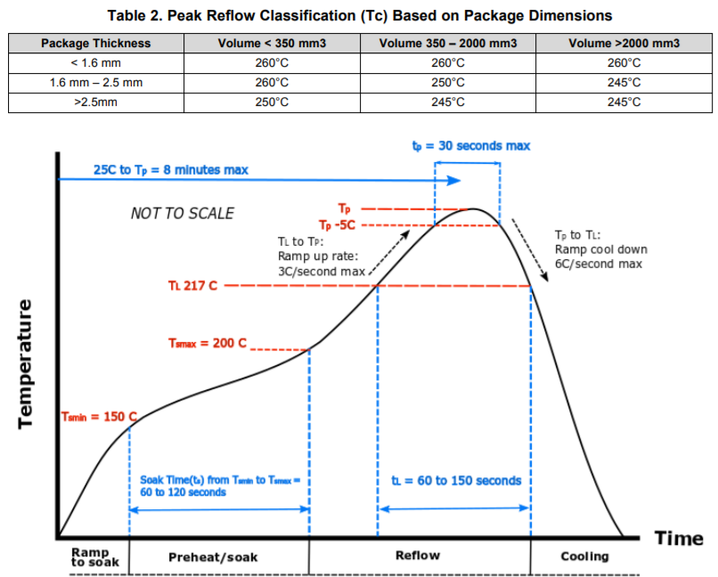

    Yes, you can hand solder the part without any issues. In fact, you can control temperature and soldering time way better than other production method. If you concerned about soldering temperature, you may use Pb-Sn solder, and select a proper soldering iron temperature (~400F or 204C) and/or soldering tip for the hand soldering application. There are no specific hand soldering recommendation for the part, since it is likely that hand soldering temperature duration is significantly less than peak reflow classification specified in the Table 2 below.

    A typical double sided board will go through the reflow oven twice. If there are soldering issues, the populated board may be reflowed once or twice more.

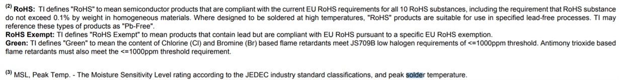

    MC33078 is compatible with RoHS requirements and JEDEC standard.
    Peak temperature recommendation for reflow can be found in the following documents.
    https://www.ti.com/lit/an/spraby1a/spraby1a.pdf?ts=1597846673226&ref_url=https%253A%252F%252Fwww.google.com%252F

    The optimum temperature of this lead-free solder is 250°C, so we aim for a peak soldering temperature of 260°C or less. (Iron tip temperature 280-270℃, within 2 seconds)
    Hand soldering is done so that the heat stress is not greater than the peak reflow condition. Is the idea appropriate?

    A typical lead-free solder's melting temperature is approx. 217C or 422F. Pb-Sn based solder's melting temperature is approx. 183C or 361F.
    It seems that you have special Pb-free solder with much higher melting point. In this case, I would recommend to experiment the hand soldering procedure on a spare board. Please select a adequate soldering tip size that will carry enough thermal energy when in contact with soldered pin. Make sure that you use adequate amount of flux to limit the surface metal oxidation, keep metal surface clean and increase the heat transfer during soldering process.
    I would reduce the solder iron tip temperature as low as it can (while still maintaining solder flow characteristics during soldering) with above guideline. Adequate amount flux means to cover the solder pins with generous amount of flux,  which the flux should cover all over the soldering tip and pins during the hand soldering process. You can clean the excess flux when the job is completed.
