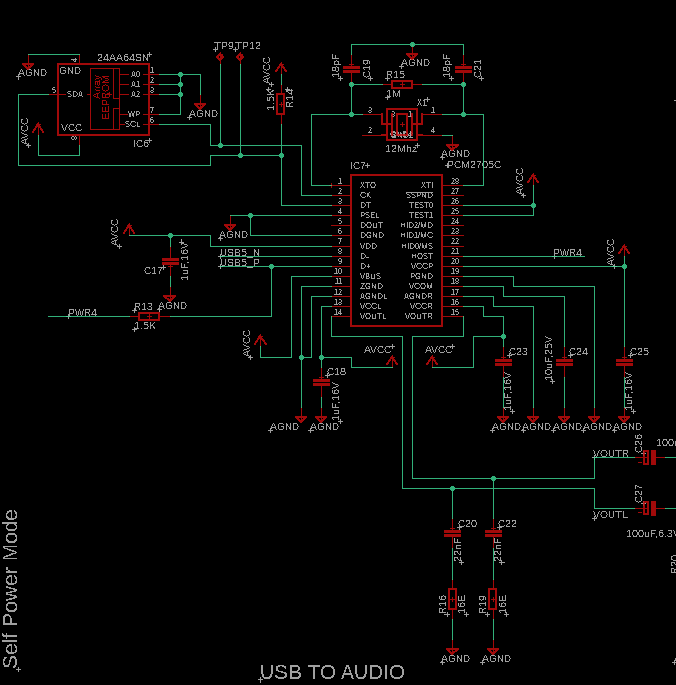

I am trying to modify the ROM Descriptor data and I followed the instruction given in the datasheet. but when I plugged the device it won't show Vendor string as I programmed into the EEPROM.
I am using self power mode. Could you please help me to resolve the issue. I have also attached the Schematic of my design.

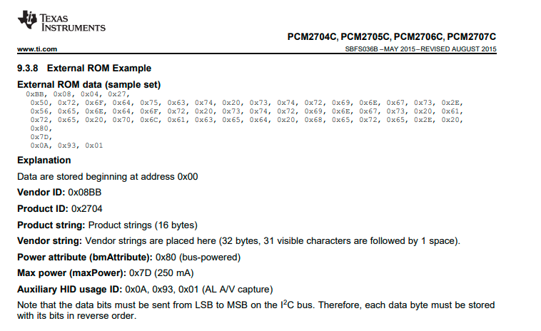

I stored the below value in the EEPROM as shown in the sample set in the datasheet.
0xBB, 0x08, 0x04, 0x27, 0x50, 0x72, 0x6F, 0x64, 0x75, 0x63, 0x74, 0x20, 0x73, 0x74, 0x72, 0x69, 0x6E, 0x67, 0x73, 0x2E, 0x56, 0x65, 0x6E, 0x64, 0x6F, 0x72, 0x20, 0x73, 0x74, 0x72, 0x69, 0x6E, 0x67, 0x73, 0x20, 0x61, 0x72, 0x65, 0x20, 0x70, 0x6C, 0x61, 0x63, 0x65, 0x64, 0x20, 0x68, 0x65, 0x72, 0x65, 0x2E, 0x20, 0x80, 0x7D, 0x0A, 0x93, 0x01

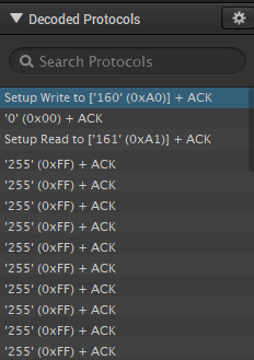

    I think this issue is somewhat like my problem,
    I also checked the Data lines on the protocol analyzer and found the results as the above case.
    The EEPROM is not sending the data as it needs 2x8 bit address to read/write.
    Nikesh
  • Hi Nikesh,
    I agree, I believe that is the problem.  The EEPROM you have selected only supports 16-bit addresses, and the PCM2704C only supports 8-bit.  Can you try to use the 24AA08?

    I tested the PCM2704C with the AT24C16 IC and I am able to change the VID and PID.
    As per my testing, PCM2704C does not support the EEPROM which is having a size more than 16KB like AT24C64 (Mentioned in the Schematic of PCM2704C EVK). we can use AT24C16 or AT24C08 EEPROM.
    Also All the EEPROM sample data should be in reversed order e.g. if the VID is 08 BB then it should be stored in the EEPROM as DD 10 (Reverse the bit in Binary and Convert into the Hex).
