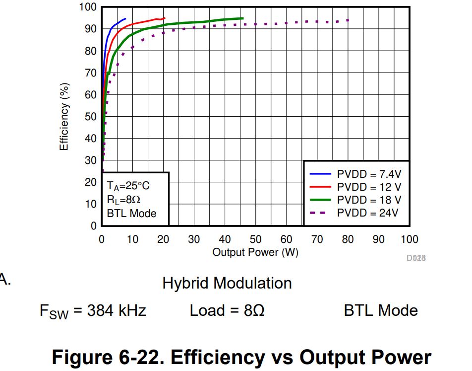

Hi all,
Could you please tell me the accurate efficiency at 5V PVDD, 2W, 8Ohm speaker?
I could find 7.4V, but I could not find 5V.
Could you please tell me accurate persentage?
Thank you

Efficiency is related to various configurations, such as LC filter, PWM switching, modulation. The datasheet plots are just to be one reference data based on EVM measurement, which couldn't guarantee all conditions, such as 5V, 8ohm, 2W.
It's suggested to order TAS5825M EVM and measure your system condition.
