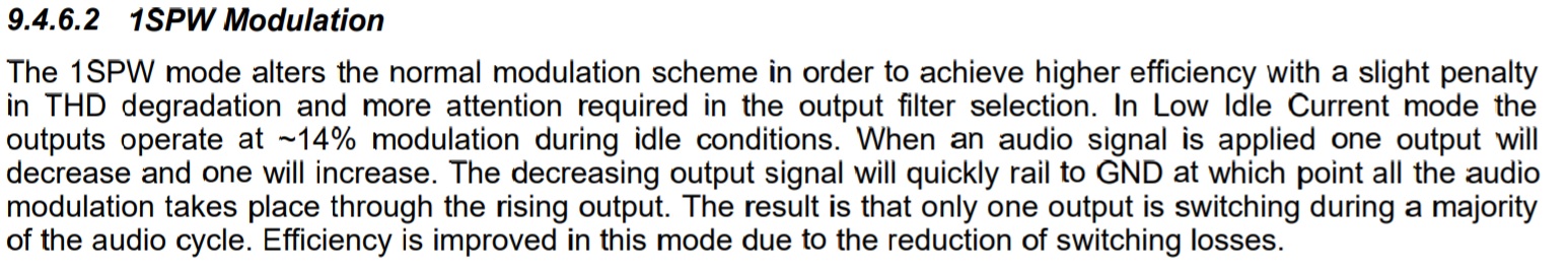

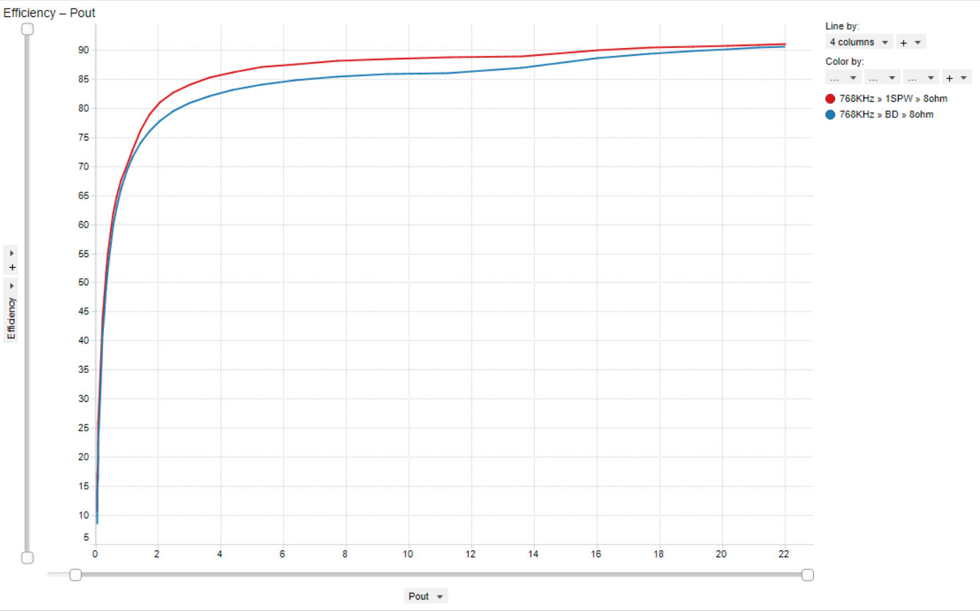

Please provide TAS5825M 1SPW modulation efficiency waveform,cause customer need comparison TAS5825M BD modulation and 1SPW modulation efficiency,

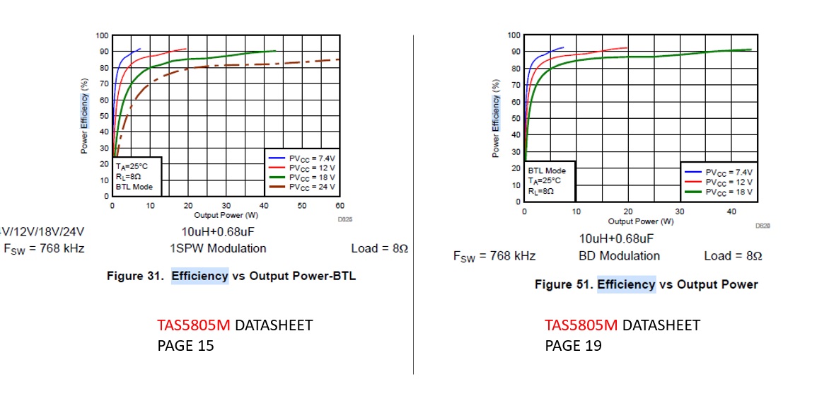

For TAS5805M example, the TAS5805M efficiency table BD modulation and 1SPW modulation.
Customer is currently evaluating the efficiency data of TAS5805 and TAS5825, so such information is needed.
