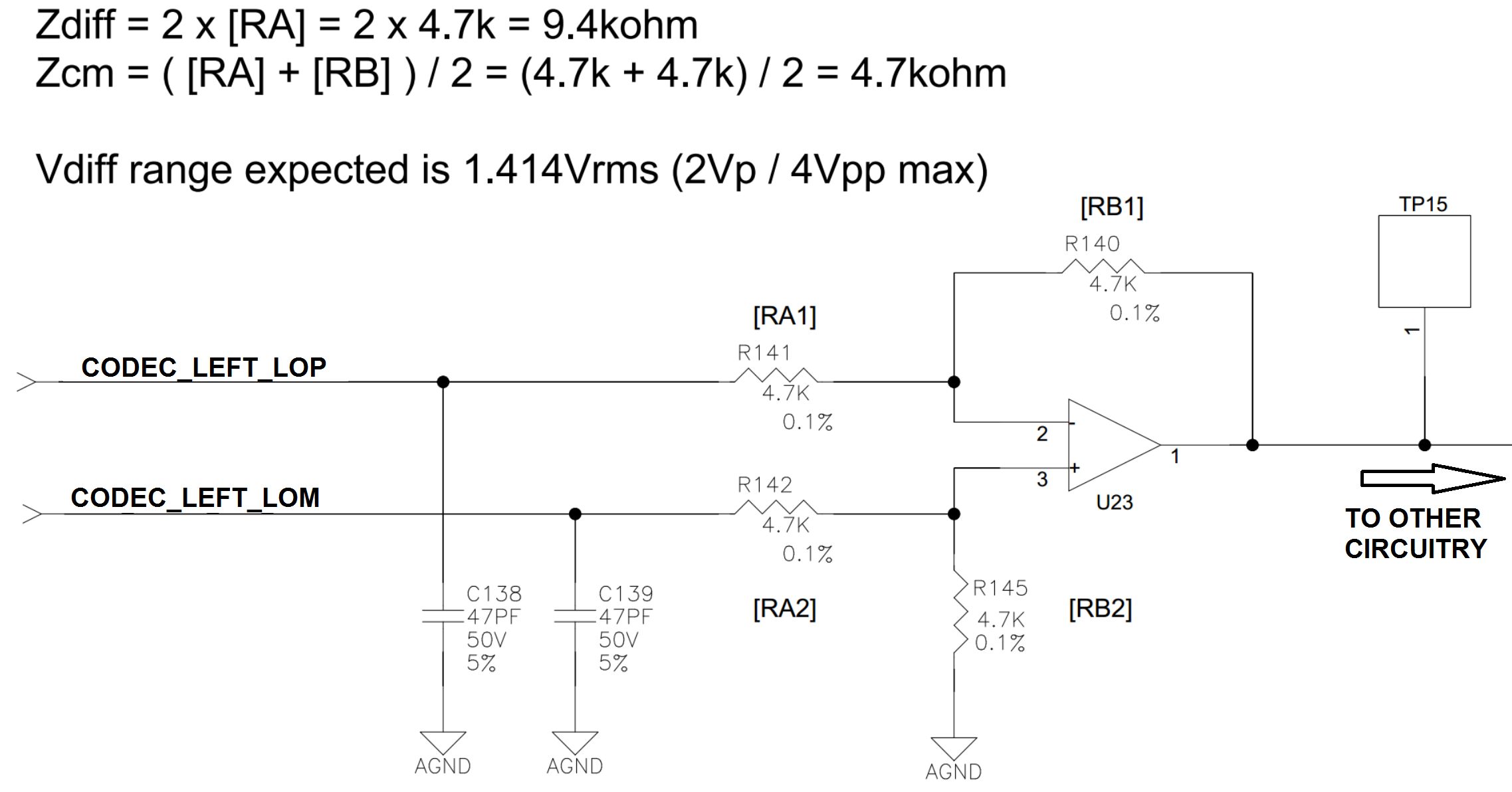

    If the above looks correct, perhaps there is something wrong with the circuitry directly connected to the codec LEFT_LOP/M?  See below.  All output measurements were being measure from Test Point 15 (TP15).

  • Hi Aaron,
       I was able to access the LEFT_LOP/M direct via the R141 and R142 on the top of my board.  However, I did not see any voltage or CM voltage present when DC or AC coupled on the scope.

    Here is the main wiring of the codec.  Do you see any issues here?
  • Hello Gregory,
    The only worry I see from the schematic are the pull down resistors on the inputs. I see they are DNI so are they unpopulated on your board? Unused inputs should be connected to GND via 0.47uF capacitor.

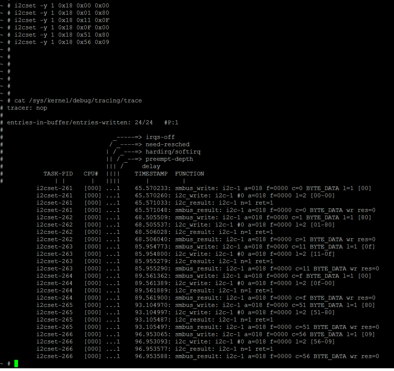

  • Hi Aaron, That is correct. All DNI are not populated. The only I2C transactions ai am doing are the i2cset commands and then the i2cdump command to verify each register has been correctly set to that value. I have done one by one verification at least to that level. Is there something more detailed that you are looking for? Thanks!
  • Hi Aaron,
       I did some snooping on the I2C within linux.  Does this help?
    Thanks!

    Reading register writes is nice but I would like to visually see that the device is getting configured. As for some next moves, is it possible for you to remove R141 and R142 and then probe the device output? I would just like to isolate the Codec's outputs.
    I am not sure what the RIGHT_LOP/M outputs are being used for but can you try and power on the driver by writing 0x0B to register 0x5D? You may also try one of the HPOUTs. HPROUT driver can be powered on by writing 0x0B to register 0x41. This is just to ensure we can visually see the device getting configured correctly. These outputs should show the default ~1.3V CM when powered on.
