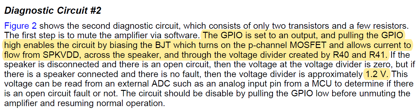

2. When they test open load diagnostic, do we need to disable our device firstly? Because the SPKM always output square wave even though open load fault occurs. Could you please tell me the mechanism of detection? How to compute the 1.2V? Is there any difference if the disconnect happens TP1 and TP2?

    2) Yes, in order to perform the open load diagnostics, the customer needs to be muted. Otherwise, the detection circuit won't work properly.

    2) When muting the amplifier, the speaker output should be disabled, right? The output should have no waveform, right? Page 1/register46 and page 1/register48 are both speaker volume control, and they both have mute choice, what is the difference between this two mute choices? If I detect open load, should I choose which register?
    3) I don't know why the resistor divider is 1.2V when there is no fault. If the SPKVDD=5V, then the  resistor divider should be 2.38V rater than 1.2V.
  • Hi, Sherry,
    1) I recommend to use page 1 / register 48. It's true that  page 1 / register 46 can be used to mute the device too, but the output will still be active in this case.
    2) Your calculation is correct. I think this value was calculated with the minimum SPKVDD value that the TAS2505 can support (~2.7V). You should get a higher voltage with a SPKVDD level of 5V.
